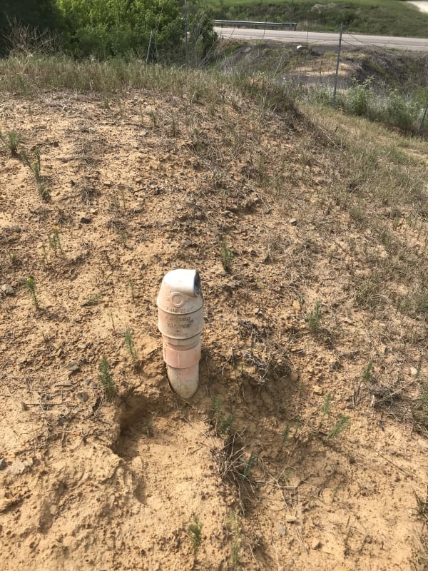

One potential problem with the current system is the air break at the system high point (the top of the levee)
Without a sketch reference, it seems that the water discharge needs a vacuum breaker in additional to the air relief valve, refer to the photo below.

I may have used the term air break incorrectly, that’s what everyone around here calls them. This device is a simple floating ball in a cage. When there is no water the ball falls down and allows air to either enter or exit the pipe, if the water level gets high enough the ball will float to the top and seal the port blocking the water from flowing out. Like I mentioned before, the water never pushes the ball up and there is a vacuum there sucking in air all the time. At this time I’m not worried about the pipeline addition but making this one work correctly when I have to move it.
Basically I have a sump pump that has the discharge line rising 25’ above the pump and back down 10’ with an open ended discharge line with one air/vacuum break located 3’ after the pump and another located at the high point (25’)

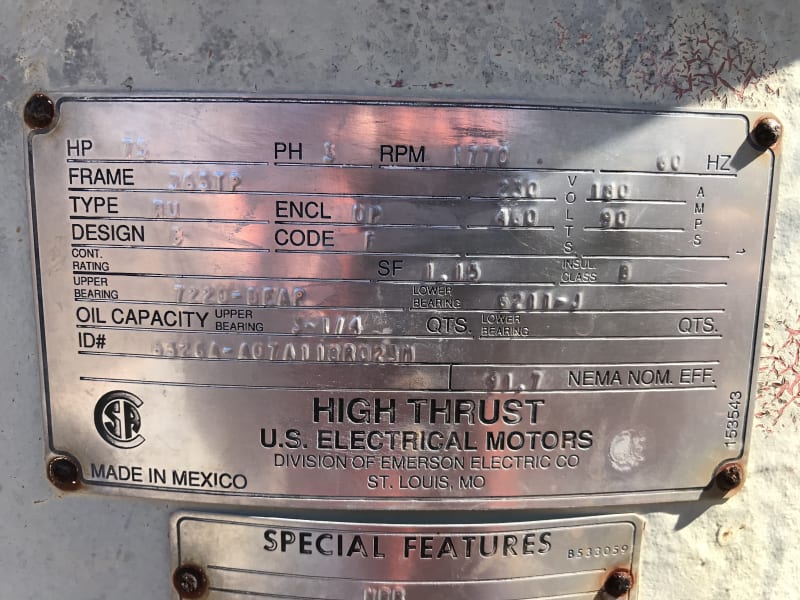

Can you post the pump make, model and any nameplate data? how is powered? If electric can you measure voltage and current going in?
As you new pipe is longer, the hydraulic gradient will be different and this may eliminate your issue with vacuum at the high point. But without the pump curve you can't calculate or predict anything. Do you have flow measurement at the pump? If you can then you could create a curve if you can't get one.
Thanks for all the help. I have requested the pump curve from the manufacturer again. I will take photos today and try an explain the system better. I have taken voltage and current readings before to make sure the motor wasn’t running unbalanced 472VAC and 84amps on each phase. The system is really rudimentary, I will try and get a pump discharge pressure next time I run the pump. The pump runs in batches, 12-14 hours on and 4-5 days off. I calculated TDH by adding the system static head and all the piping flow restrictions and friction using 5200gpm as the flow rate.

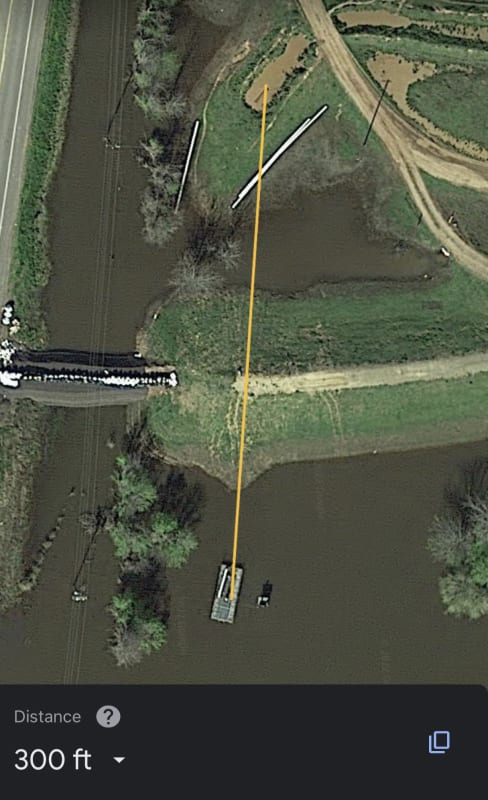

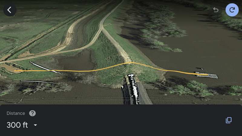

Here are a couple photos the aerial picture was taken during a flood a few years back but it shows the general layout. The other are nameplate photos. I will take a couple pictures today when I get up there.
Well with a serial number I'm amazed they can't give you anything more than a supposed duty point.
J line seem to have turned into American Marsh (bought them out apparently),but none of their current ranges seem to match yours, though the Wilo turbine pumps come close.
and 300 ft of pipe is a lot different to 500 ft....
The barge usually sits about 30’ farther back and the 300’ shown on the drawing doesn’t account for vertical footage, it’s probably close to 450’ to be more exact.
