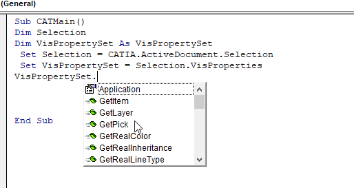

I'am trying to create a macro to change the line color in a geometrical set but can't figure out to acess the property that i want.
I have a set of lines that are inside a geometrical set, but they are white i want to change them to another color.
when selecting the geometrical set and acessing to its graphical properties when i change the color in lines and curve color, it changes the color of all the lines inside(what i want) but i'am not being able to acess to that property by macro. can someone help?

Not easier to add your lines to selection and use visproperties.SetRealColor ?
Like TudorM said,
You have to go with visproperties.
Then you have access to graphic properties.

Here an example of changing a color of selected elements.
Code:
Sub CATMain()
On Error GoTo 0
Dim InputObjectType(0)
Dim partDocument1 As Document
Set partDocument1 = CATIA.ActiveDocument
Dim Selection As Selection
Set Selection = partDocument1.Selection
Dim shapeFactory1 As Factory
RED = 175
GREEN = 255
BLUE = 175
If (Selection.Count < 1) Then
   MsgBox "      Nenhum elemento seleccionado !" + Chr(10) + Chr(10) + "     Seleccione os elementos, e repita o comando.    "
    Exit Sub
End If
Dim MyPropSet As VisPropertySet
Set MyPropSet = Selection.VisProperties
MyPropSet.SetRealColor RED, GREEN, BLUE, 0
End Sub
