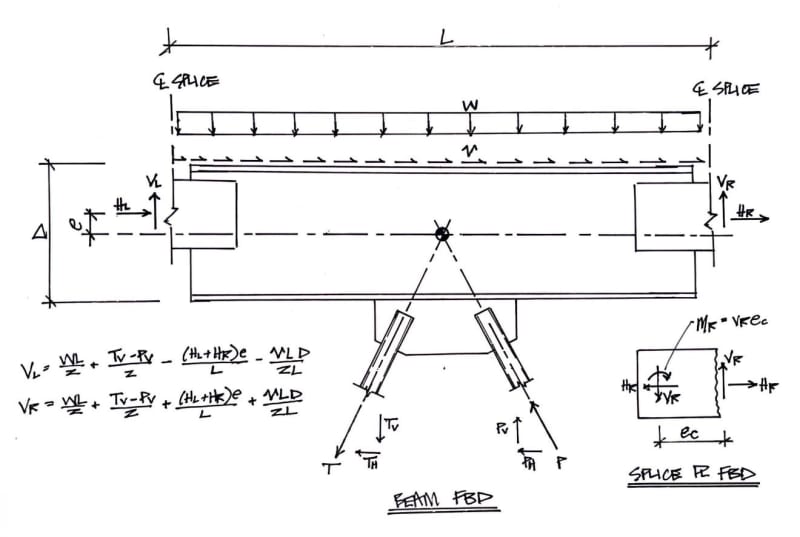

Does anyone have any references on designing double plate welded shear splices on steel WF girders?
Risa Connection checks the limit states handily, however it forces me to match the web thickness across the joint.
Makes sense from a construction standpoint, but man it is costing my connected girders dearly in weight.
The nature of this frame line is such that there is a chevron brace with BRBS controlling the design of a girder (W36x160).
Now I need double plates to drag the load into that sucker so the beam I am splicing it with has to match the same web thickness 0.65" makes for a heavy beam no matter which depth class I choose.
If I could shim out or deflect the splice plates Then I could perhaps get away with a smaller web and a much smaller beam on the drag side of the frame.
The drag beam that calc'ed out without consider this is a W24x76, in order to match web thickness the next least weight beam I could find is W24x146! A local reinforcement at the connection would certainly be more material efficient but I'm not finding any resource on that and I'm not even sure it could be built properly because the shims would need to be pretty tight tolerance and most likely off dimension thicknesses.
Your all collective wisdom and advice would be appreciated here. I suppose its not the end of the world if this collector line is twice the weight but it feels so wrong to put a beam with a UC less than 0.5 up there.
I suppose I could try to make all the splices work using one sided, but with the loads at the braced frame I really don't see anything fitting. Things are getting pretty close to UC 1 with a double sided GR 50 PL 5/8"x24"Dx32"W with 5/16 Fillet weld to beam web. It feels big. Don't really have a feel for whats going to be cheaper and easier, an (even more) monstrous splice plate and welding configuration or just heavier girders.

One thing that isn't clear from your print out, is where are you putting your zero moment point? Based on the calcs that it is giving, it appears that RISA is saying that the zero moment point is the weld centroid on the right (W36x160) beam - per the "Plate Flexural Yield Check" ex is 23.16". I would contend that the zero moment point should be in the middle of the splice plates. That will reduce the moment demand by about 24 kip*ft on the plate (shear * ex).
As for the vertical eccentricity, couldn't we say that the W36x160 is strong enough to be able to accept the moment from offset centerlines and keep that eccentricity out of the connection? In my mind, I'm envisioning a shear lag (yes, like from Part D) effect, but for compression. That might be totally off-base, and if it is I'm sure some of the more mechanically sound members can correct me.
At any rate, if you CAN reduce the moments on your connection, then you should able to (hopefully) reduce your weld size. If you can get it down to a 3/16" weld, than you can have a filler plate of 1/8" thick on each size and still have a single pass weld.
When I was going through the problem manually I also figured the point of no moment was at the centerline of the splice. It seems to me that eith this assumption the plates still need to carry the full moment, but aisc says if the connection is symmetric then the welds would designed for half of the moment. I liken this to a beam model with a clamped slider and a point load. I need to think about the mechanics of that eccentricity some more cause I agree that risa I think made a simplification that is turning out maybe too conservative.
Ex in this case is taken as the distance between the weld center of gravitys.

I agree that the point of zero moment would be at the centerline of the splice so long as that is consistent with how you designed the framing. I'd also be designing the connection for direct axial (no eccentricity) since the strong-axis stiffness of the W36x dwarfs the stiffness of the connection. Obviously be sure the check the beam for this additional moment.
I want to get on board with this, I believe this is the approach taken in the past for this detail at my office. I'm am however having a hard time reconciling the statics of this assumption. I guess what were saying is that I order for moment to really enter the s pp lice plates, it has to have a compatible rotation with the end of the W36, if I did a stiff ess analysis of the joint there would be only a small rotation of the w36 that would only develop a small moment in the splice.
This is how I see the statics of your condition. Detail the splice plate to accommodate the beam end rotation like you would for an extended shear plate.
