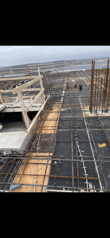

Hello great minds, I have been having sleepless night after a visit to a construction site.I noticed the third-floor slab openings for stairway didn’t have diagonal bars, just vertical and horizontal bars. My question is without the diagonal bars will there be cracks which could result to collapse of the floor.I’m new to site visits for flat slab system.
 https://files.engineering.com/getfile.aspx?folder=821a49af-fe9a-4caa-bb39-be0abcf35a95&file=B5AE40EB-D83C-4537-8107-7B6700891FA4.jpeg
I don't know the circumsances, but other than concrete water tanks, I don't use diagonal bars... horizontal and vertical generally provide lots of reinforcing.
There might be some minor cracking that wouldn't have otherwise occurred, but certainly no collapse risk (assuming orthogonal reinforcement is adequate!). Diagonal bars won't stop things from falling over.
Agree that diagonal bars are not included for capacity. They are sometimes used for control of crack propagation in the reentrant corners.
Agree with the above. Diagonal is more for control of cracking at re-entrant corners, rather than strength.
I picked up not using diagonal bars from RJC, over 50 years back, who at the time were probably one of the best RC engineers consultants in the country. The last company I was with, Lavalin, had a blog where engineers asked design questions. One of the topics that came up was the use of diagonal bars. I was surprised that so many engineers still used them. If you want them for crack control, then increase the size of the bars framing the opening, and eliminate them. One of the problems is that they increase congestion of reinforcing in a critical location leading to poor concrete placement, just where you don't need it. Forgot to add, with water containers, you are generally looking at much thicker walls and the congestion is less of an issue, and crack control is generally a good thing. I wish I could think of all the reasons at one time.

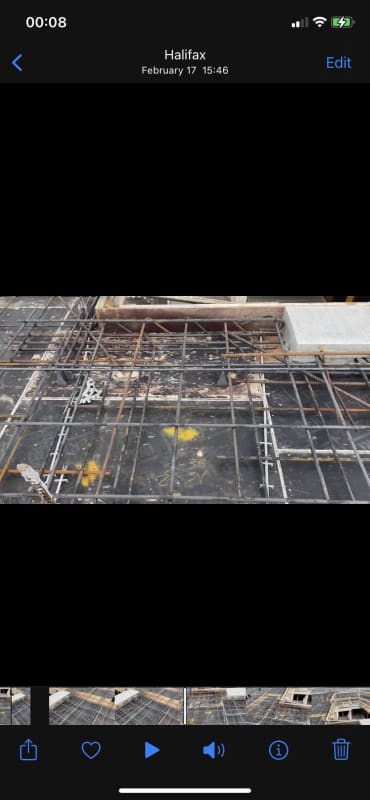

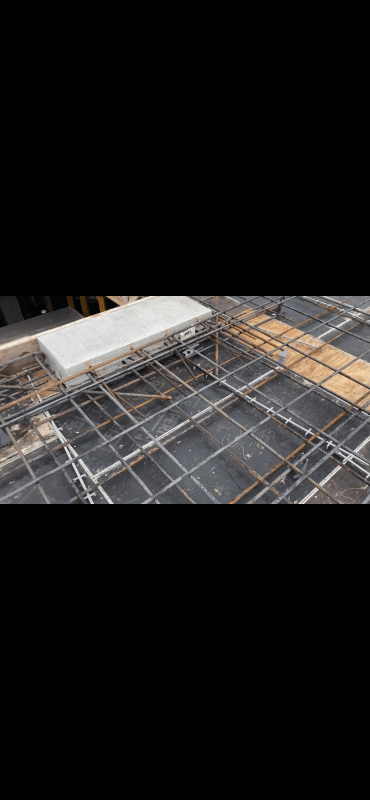

There is a part I forgot to mention though, a side of the opening had diagonal bars, the other side didn’t.I’ve attached the picture of the other side. Won’t stress be transferred from the part with diagonal to the part without? Or it’s still the same scenario like you’ve earlier stated “the horizontal and vertical bars” are good to go?
Multiple irregular openings can be a challenge... again, best handled by orthogonal reinforcing. [pipe]

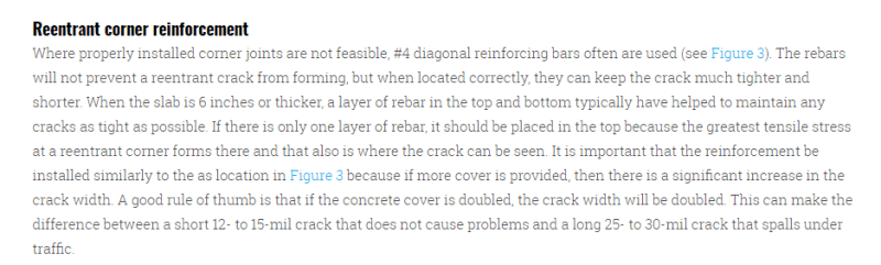

My money's on "yes". This speaks to slab on grade but I suspect that much of the principles would still apply: Link
For small openings in a SOG, I don't add corner bars, but at re-entrant corners I do. There's a big difference in why the slab cracks at the corner. In one case it shrinkage, in the other it's restraint. [pipe]

Are you saying the fact that one side of the opening has diagonal bars and the other side don’t would impact the structure? or you’re saying the horizontal and vertical bars provided would be sufficient in this case?
