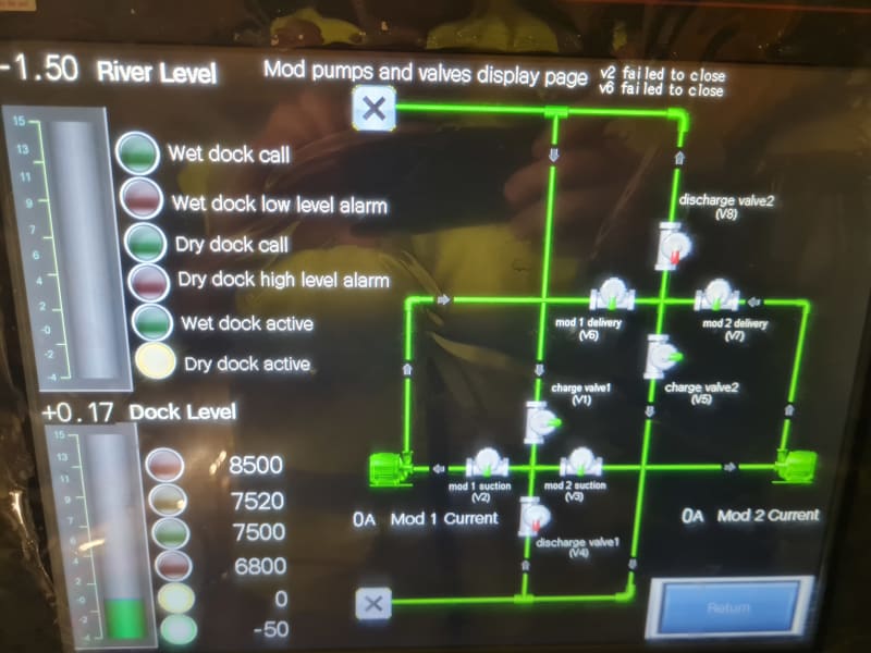

Hi guys,
I work at a dry dock facility and its bothering me that I dont know as much about our pumps as id like and I also have questions about our set up.
Should all pumps have a gauge on suction and discharge side and if so how do I read the information on them? What can it tell me?
Is there tests and data I should gather and make note off to later use to diagnose faults? Such as time to pump a certain level of water out of a dock?
Will the tide level pumps are pumping against make a difference to pump times?
Regarding the schematic attached is it better to have 2 pumps running or just one? Will 2 pumps reduce discharge time or will they fight against each other and end up worse?
I am sure I will have more questions! Thanks in advance
 https://files.engineering.com/getfile.aspx?folder=e0144c8e-3987-4d95-99c1-dbdab0c35afd&file=20220817_081720.jpg
If the pumps are discharging end to end like it is shown on the diagram, it will just fight each other.
But maybe installation in the field is different and they are actually in parallel discharging to a common header. In this case, then you would increase flow rate. Now, be careful as if the pipe size was designed to a master+backup pump scenario, by putting both pumps running you might go over the pipe admissible pressure..

Thanks for responding.
It actually looks like they discharge into a t-piece, 9ne from bottom one from the side to the discharge.
Coupd you explain to me how pressure works in a pump? Does it g up or down with flow rate?
There is also a lot of vibration within th3 pumps and pipework which is causing me concern, also the bolts on the flanges are only with an ordinary nut, no washers or anything is that normal?
I am embarassed to be asking these but its never actually been explained to me.
How is it that discharge valve 1 appears to be in the pump suction?
Perhaps you should verify if those are cross fittings or the pipe simply cross over each other without connecting. I can't see any difference in that photo. Can you make a schematic, so we don't have to guess what's going on.
Is this supposed to be able to pump from one of the Xs to the other X1 to X2, then turn it around and pump form X2 to X1? Please explain what you are trying to accomplish, or what this system is supposed to do.

So the discharge valves should be open when the dock is being discharged "pumped out" and the charge valves should be open if the dock is being charged (wanted pumped in) the cross fitting after discharge valve 1 is connected to all those pipes as is the cross fitting after discharge valve 2 every other cross point is just pipes running past each other not connected. You can open the charge valves and discharge valves and by pass the pumps and have water pass directly into the dock or out of the dock depending on river and dock levels.
The top X represents a manually controlled valve on the river side of the system and the bottom x represents a manually controlled valve on the dock side. Both are usually open. So yes the system is supposed to pump in either direction.
Thank you for the information, so would I be right in suggesting that as these pumps come from a common point at X and eventually deliver through another common point they will not fight each other and in fact assist? Is there any reason why you think they should not be on at the same time?
DiamondDave,
I took the liberty of redrawing your piping into a little more straightforward process layout which might be easier to follow. Please take a look and check the logic, but I think I followed the photo, just splitting the crosses into headers to allow rearraging the layout. I'll comment again when time permits to go into a bit more detail and some pumping basics, unless someone else beats me to it.
Hey there Rputvin, thanks for that schematic. That makes it a lot easier.
I assume that the schematic is correct and those are identical pumps.
With info given, minimal, I don't see any reason that you could not run 1 or both pumps. With identical pumps you will get more or less twice the flow as running one and the discharge pressure will be about the same if you run one or two pumps. It could be a little less flow than 2X and a little less pressure, because flow resistance increases at 2X the flow. If you have small diameter pipe, that could be a lot more resistance, causing a marked decrease in both flow and pressure.

So am i correct in drawing from what you say that both pumps going into a t piece into a common outlet wont fight each other?
