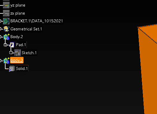

hi there
i come across a file at work that has tree like the uploaded pic.
they designed a forge part in one body and then add it to a another body as a solid
then for example add a hole to that solid
now if i change the external diameter of forge part(first body) the second body will change too
it seems very helpful for parts that machined multiple times.
 https://files.engineering.com/getfile.aspx?folder=1f5147fc-07cf-4003-8d88-c8bb4c532bfc&file=03.JPG

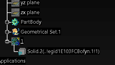

If it came from another part, it would have this icon:
With publication like this.

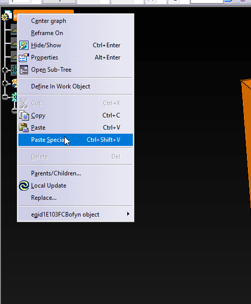

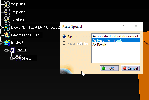

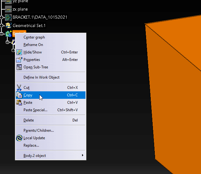

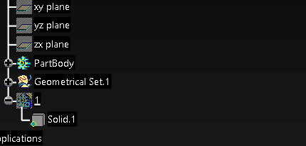

To recreate the steps made in sample, you would need something like this:
1-
2-
3-
4-
Hope it helps!
