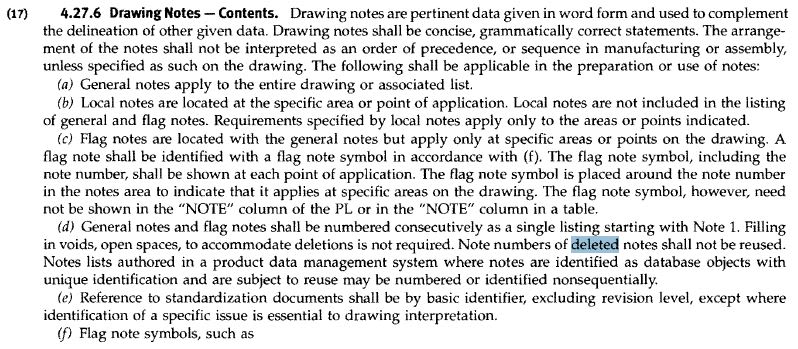

All I can find is in ASME Y14.100 4.27.6(d) talking about not re-using the same note number, which everyone at my company agrees with, but there is no mention of leaving the number there and adding the words "DELETED" or similar. The closest I can see is if we stretch the requirement of the notes being numbered consecutively.
(d) General notes and flag notes shall be numbered consecutively as a single listing starting with Note 1. Filling
in voids, open spaces, to accommodate deletions is not required. Note numbers of deleted notes shall not be reused.
So my question is if there is a hard written rule on this matter, or if the quote above is all there is on the matter? I didn't see anything directly helpful in 14.35 for revision control either, but my copy is from '97 so its possible the latest has mention somewhere.

I can only find this.

To ctopher - Yeah, that is all I found as well, which is at least enough for me to have note numbers not shuffled when deleted.
