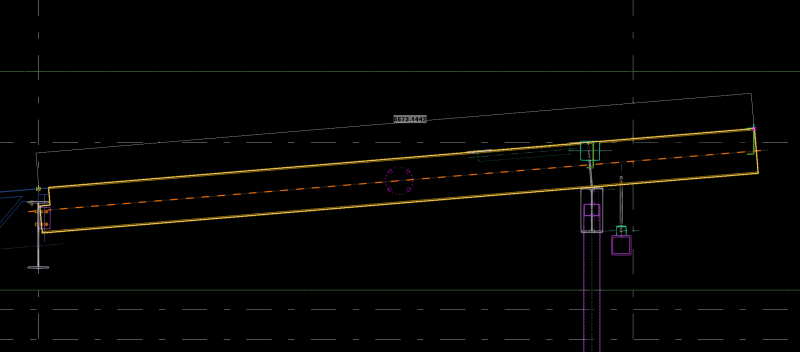

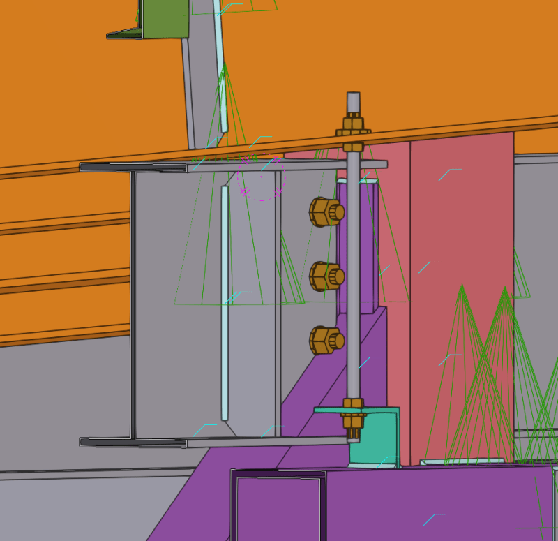

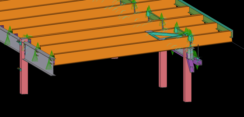

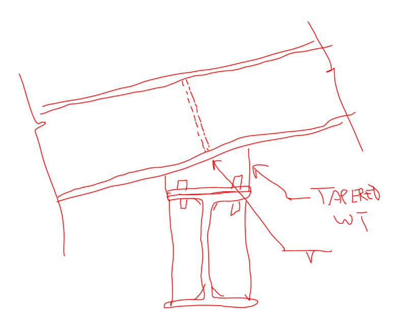

Hello,
I am currently working on a beam connection where the Engineer of Record has a segment of a W-beam bearing directly on top of another W-beam. Because the supporting beam is in regular configuration, the supported beam is not bearing much on top of the supporting beam. Does anyone have an idea on how to resolve this issue? Initially I was thinking of rotating the supporting beam so that the supported beam can get the full bearing however, I have yet to hear a response from the EOR. I have attached several images for your reference.
Thank you
I've dropped the supporting beam a few inches and detailed a bent plate that can be welded at each end. If the reaction is high enough, include a gusset aligned with the web above inside the bent plate.

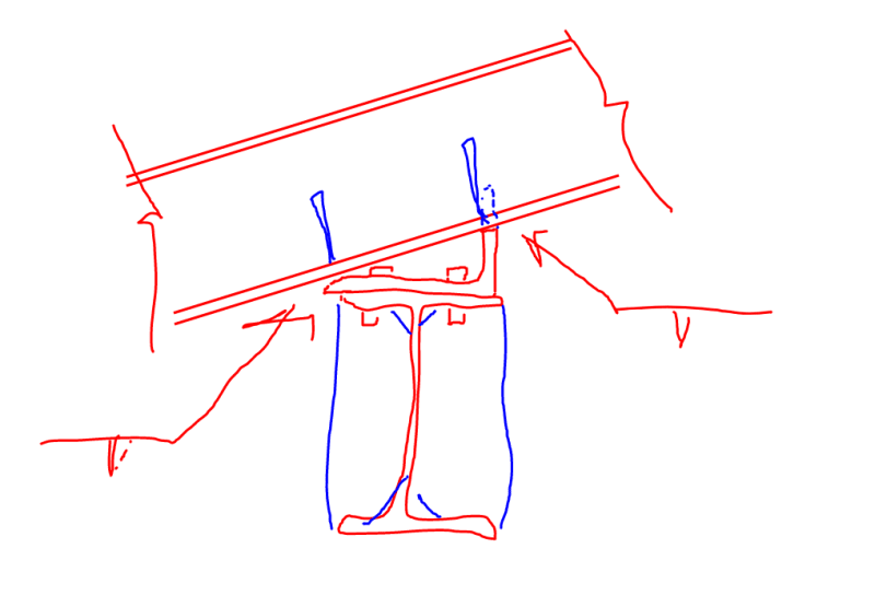

Dropping the girder and fabricating some kind of level bearing seat is pretty conventional stuff where the girder can be dropped. That said, whatever form the seat takes, it would need to be done either at every single beam or continuously along the girder. There would be some modest $$$ associated with that.
A pretty economical seat might be something like this. Just keep an eye on bolt access and design the WT such that it doesn't flop over laterally. It appears that you have roll beams bracing each beam beam pair so your rollover concerns there should not be significant.
I was going to suggest that same sketch which I’ve used before.

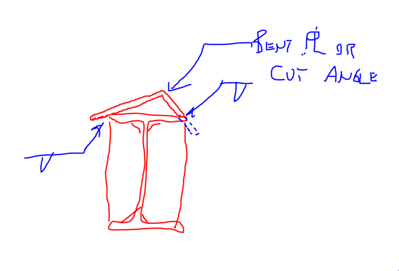

I feel like we could use a few more sketches here. I assume that this is what we've been talking about with respect to a bent plate solution that the supported beam would need to be welded to.
This is a little more awkward mechanically but, if the clip were wider than the beam, you could bolt it down. I don't know that all -- or even any -- of the stiffeners shown are actually required. Their absence would imply the utilization of plate elements in bending however.

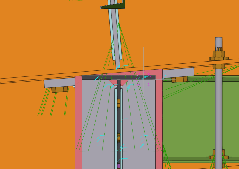

The fabrication company that I work for does not have a standard steel shim nor a machine that is capable of cutting out shim. We could use the plasma table to cut multiple thin shims according to the max plate thickness the plasma table can cut through. I believe some shops may have the machines that are capable of making shims.

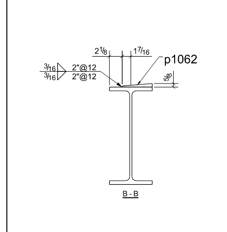

I have a project that I inherited after the framing layout directions were set. It has joists sitting on shim plates, the below is from the fabrication drawings. They made the shims continuous across the top of the girders on the shops instead of being a single shim under each individual joist.
I would still drop the girder (if possible) and provide the WT supports in the OP case and not mess with shims.
