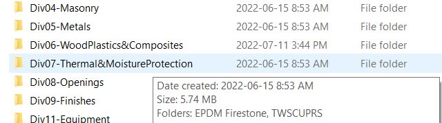

It's never been a consideration... over the decades, I've got blocks for hundreds of shapes... filed as:
and under 05-Metals:

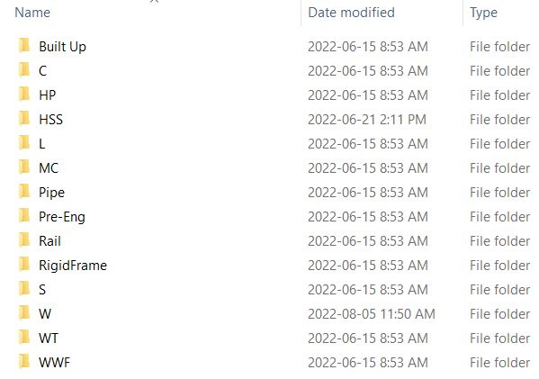

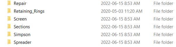

and under Sections:

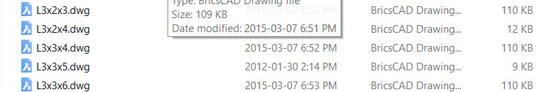

and under L:
You can see from the dates that they have been accumulated over the years.
