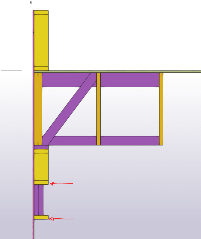

In most cases the width of our built members does not equal our wall width, so we normally have a plate above and below for finishes like the sketch below. I guess the question I have here is, is this a problem? Have we noted problems that need attention?
Probably not. But, then, I know that you know how this works:
3) There is now pressure on many projects to eliminate the plates to accommodate taller windows.
4) Our codes and standards are written in a way that suggests that an engineer ought to numerically assess the adequacy of all things. We're missing the requisite "don't worry about shit that hasn't been falling down" clause. Perhaps there out to be such a clause but, until there is, this kind of thing tends to create confusion within the design community.

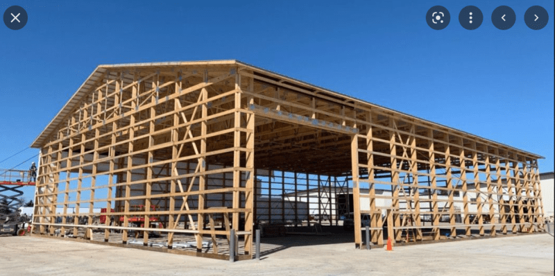

16'-20' spans are common in our area with trib loads btw 20'-40'. Below is an example of the type of thing that pops up in our area. I am not sure the engineers designing these have ever thought about out of plane loads on their headers. I am reluctant to add more details until we have some test data or a guideline from APA or the CWC.
Brad - That'll be an overhead door in guides attached to the jambs, thus placing the vast majority of the load on the jambs and not on the header, correct?
Brad -
I see many large openings where it does not appear to be considered as well. Although your picture above concerns me much less than some. In that case the header may see very little out-of-plane loads - assuming an OH door is going into that space. As long as the door spans primarily horizontal most of the door wind will be carried in the jambs. I will say that looks like a pretty tall pole barn with what looks like post boots at the base of the posts instead of embedded posts - I hope someone looked at that one prior to erection.

Pham, yes, that would be an overhead door and the header would not see a large out of plane load. We have seen them in many different arrangements. If you wanted a 12'-0" wide window at the main floor level they would not hesitate. That was just a quick image I found online. I do not get involved in pole bldgs, but I have to deal with framers that do. I am not suggesting any of that is correct, but as koot mentioned, details do get noticed nowadays by the trades on site.
RW, These pole bldgs get stood up all the time. A modern combine needs an 18'x18' door to fit easily, so 20'-0" tall walls are very common.
