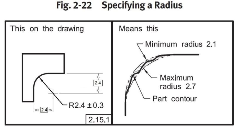

Here is the drawing example, a modified fig. 2-22 from the 09' standard:
The tolerance zone stays the same as shown, because according to the 2009 version, the basic dimensions that were added do nothing to affect the tolerance zone. Without a basic radius and a profile tolerance, there is no uniform tolerance zone between concentric arcs. Not according to any ASME or ANSI standard prior to 2018, and not according to any common practice.
Draw an internal sharp 90° corner, then fillet it by some radius. Without erasing the radius, draw a smaller radius fillet in the same corner. What shape is formed by the two radii? That's how the variation of a directly toleranced radius dimension works, and the meaning of such tolerance.
For a fillet radius. They only felt that explaining a fillet radius was required. The explanation for the figure I gave you is obvious and common practice - it looks like someone decided to do some housekeeping and codify the common practice for non-fillet radius callouts.

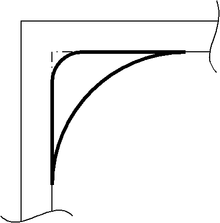

Also, technically, it isn't even a crescent - the shape in the standard has flats and a crescent shape doesn't. Yet again hijacking a word that has a common definition and limiting it to an artificial boundary.
Here's a not-crescent for free:
Call it whatever you want - crescent, semi-crescent, crescent-like, almost-crescent, sometimes-crescent, pick one you like best or dislike least. In any case, what limits the variation is not two concentric arcs, but two arcs tangent to the surfaces forming the corner.
What applies to fillets also applies to rounds (external radii). Therefore the figure you "gave" me (1-23?) would also generate the same type of tolerance zone had R8 been directly toleranced. Per the 2009 standard or earlier versions, the tolerance zone is two concentric arcs only if the tolerance type is profile (or if someone did something awkward like applying cylindricity to a radius). It is not so when the tolerance is plus-minus or limit dimensioning. Think of how a radius gage would be used on this feature.
