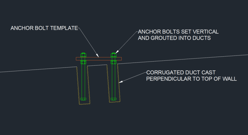

Thanks Dik - do you mean instead of casting in the anchor bolts, to have a duct/void and grout them in vertically on site?

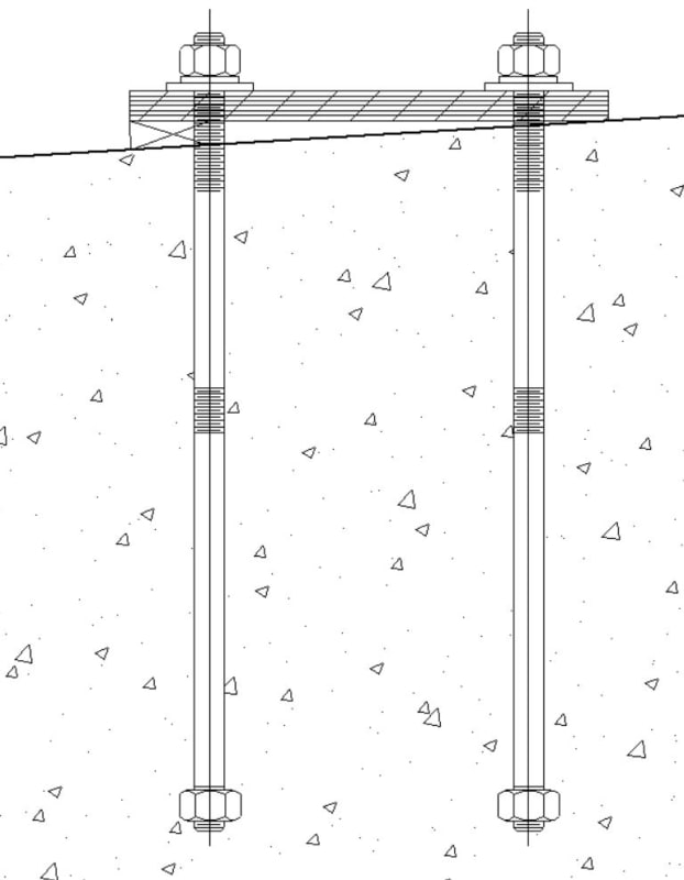

I wasn't thinking about anchorrods... even them, I'd cast vertically; I was thinking post installed. You want the nut to be flat, and that happens when the anchorrods are perpendicular to the post baseplate.
Your anchor rod template can have a bevelled base to account for the slope.
Something like:
If the slope is uniform, you can have the baseplates parallel to the top of the wall and put the anchors in 'on a slope' but only if all the slopes are the same. You have to adjust the guard height for each post if the slope varies. If only slightly, then you might be able to use the same post length and adjust the thickness of the grout. The arch might have a bit of a problem with that. Epoxy post installed anchors are sounding better all the time, or maybe weld plates and headed studs. Just noticed it was precast. This would require sleeves and grout... but still generally vertical, not sloped.

I suppose the only concern with this is that now every precast wall element will need to have its anchor bolts cast in at an ever-changing angle.

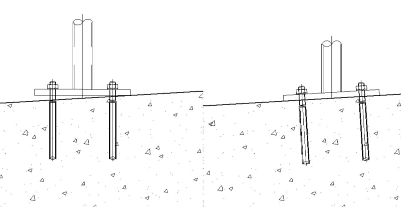

What I thought you were referring to previously is below:
That's why post applied is better... putting 4 fasteners on a precast wall using corrugated sleeves will likely be tight. How thick is your wall? can you go to CIP plates with headed studs and weld the posts to this?

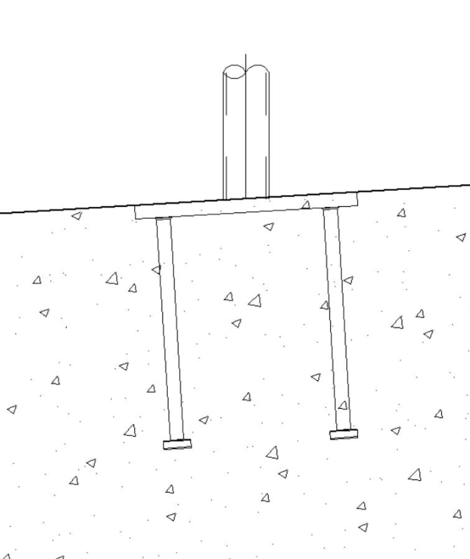

Something like...
or maybe... with HILTI HAS E-55 Anchors...

Spherical washer might be a little pricey for this; I've usually used them for X-bracing. With precast, I'd likely go for the cast in insert. It is possible to add threaded studs to the top of the plate and bolt the base to it. For drilled epoxy anchors, I'd likely choose the last sketch.
