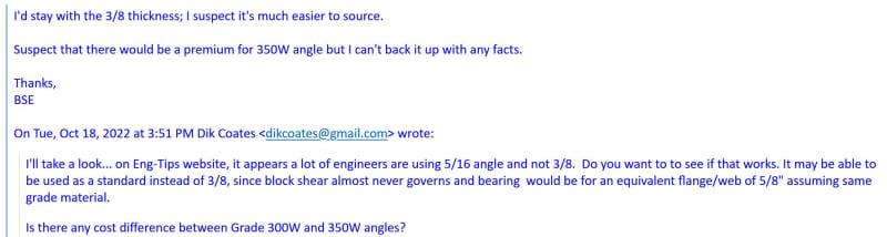

Further to this thread... still not common in these environments... I tried, Koot...
Thanks for looking into it dik. OP is in Missouri so his environ is likely better represented by the "typicals" discussed above.
I suspect that the situation in Canada is influenced by the fact that our design procedures are a bit different and our bolted-bolted table doesn't list any canned solutions below 10.3 mm. It's always hard to know if the table begot the standard or the standard begot the table.
After I commented, I added a new angle to my connection programs and the 5/16 worked out well... so decided to ask the question. It's not much savings, but cumulatively it could be a bunch.
