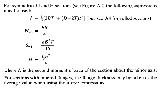

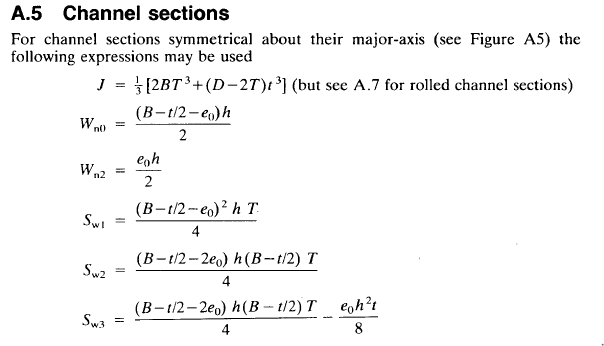

I have found them in SCI Publication 057, but for the individual shapes separately.
Any idea for combined them to calculated the W-shape with Channel on top?
