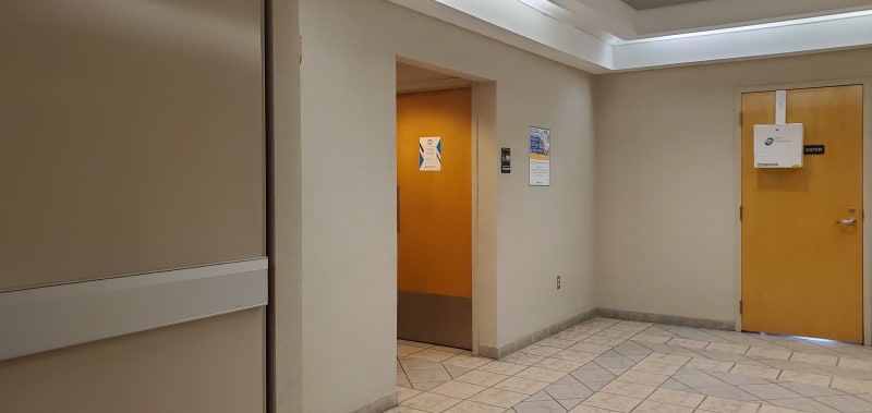

If you saw this sign, would you expect to find stairs when you turned left? This was on the third floor of a medical office building.

That's what I thought. It's saying exit, but not clarifying whether this is a courtesy sign, telling people how to exit to leave the building under non-emergency conditions, or a fire exit sign, which should direct to stairs, not elevators. This sign pointed to a dead end with an elevator bank, a locked door (which looked like it may have been an exit to a removed stairway), and two bathrooms.

The fact that it does not point to stairs is problematic, since that is one of the two possible needs for the sign, a general "this way out" as well as for emergency use, such as fires, power failures, and earthquakes, all of which could be fatal if one took an elevator instead of the stairs.

In the United States, this sign should point the way to the emergency egress. If the only thing in this direction is the elevator, the building is in violation of the fire code. If you were just a member of the public (and not working on a project in the building) you should send a message to the local fire marshal. It looks like a nice building; they can certainly afford to fix this.

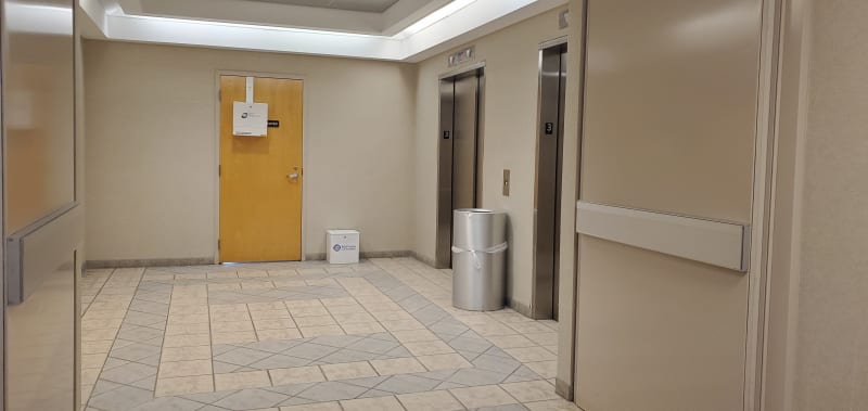

That is what I thought, but I was not 100% certain without checking the Life Safety Code. Here is what I found when I turned the corner,
Elevators and a locked door (may have been the entrance to the exit stair before renovation)
Restrooms:
That's all.

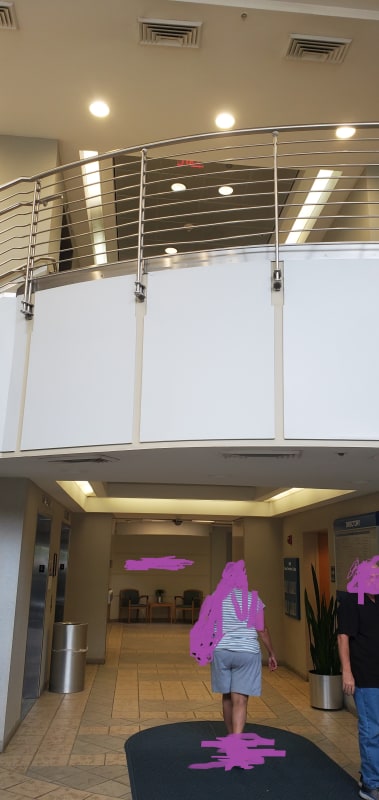

Here is a view of the first and second floors in the area below the locked door.
It looks like this building was renovated about 10 years ago to make a more atrium-like, open, and welcoming entry. My guess is that they eliminated stairs in this area to provide the open space on the first and second floors. I found an exit stair at the end of the angled hallway in the first photo I posted yesterday. There is a symmetrical exit stair at the other end of the angled hallway, which you can just see behind the tinted glass in this photo:

With that additional information, I agree, that sign is not as per fire code. It needs to point towards stairs rather than elevators, and most certainly not to a locked door or to any door without a window in it to allow viewing of what's on the other side of it (i.e. stairs ... or dense smoke ... or fire). If it points to a door at all, that door should have an additional exit sign above it indicating that this door is the way to the exit. (And that door probably has to be a fire door - and not even possible to lock.)
Fire maarshal needs a look ... but this shouldn't be expensive to fix. Definitely needs to be fixed, though.
