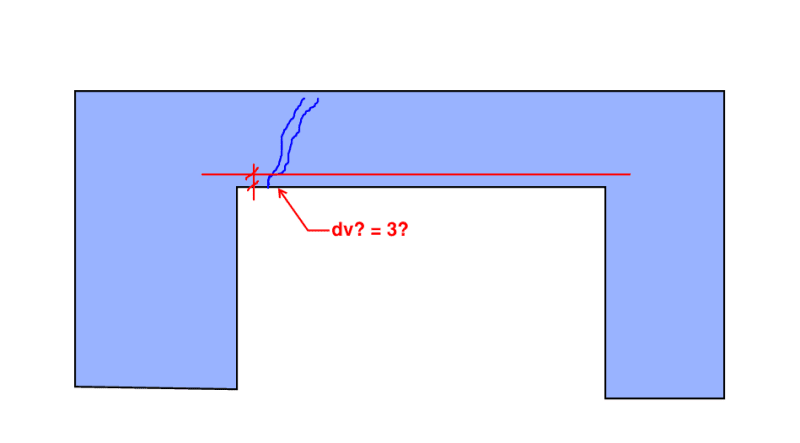

In my opinion, the primary reason that one wants top steel here is to preserve the shear capacity of the beam when it inevitably cracks in negative moment near the supports. In this situation, your shear depth basically drops to zero. From a detailing perspective, I'm of the opinion that there's no such thing as a simple span member in monolithically cast concrete.

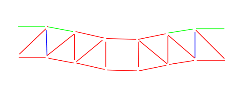

I don't believe that to be correct MC. Rather, I feel that a shear crack has to propagate across the entire cross section and induce a degree of real shear slip before the stirrups become meaningfully engaged.
What is fundamental, in my opinion, is the shear truss concept upon which we base out stirrup reinforcement. In this context, attempting to use the full shear depth of the member when top steel is not provided is akin to trying to use the blue webs of the truss shown below in the absence of the chord segments shown in green.
To an extent, this problem diminishes once the beam ends hinge and the "truss" transmogrifies into the simply supported version that is consistent with a "bottom steel only solution" and the top chord becomes a compression element across the entire span. My concern with that, however, is whether or not a catastrophic shear failure may be induced before that outcome is brought about.

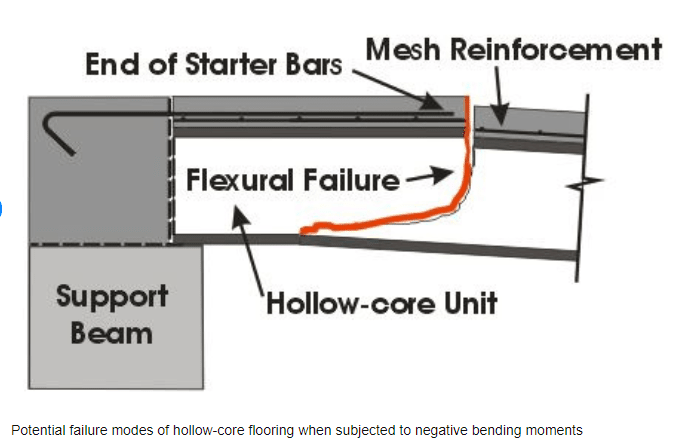

There is one example out in the wild that leads me to believe that this can be a practical concern rather than merely a theoretical one. In the literature dealing with hollow core planks, there is concern for the failure shown in the second sketch below when plank ends wind up being significantly "end clamped" at their supports.
