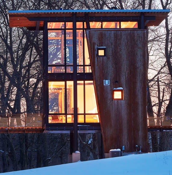

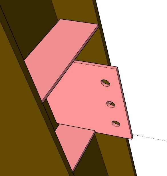

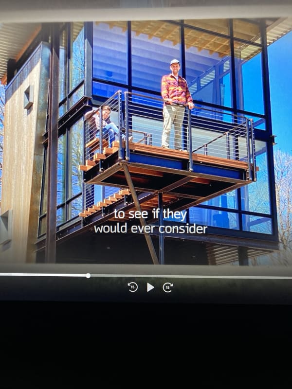

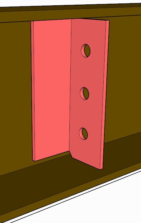

Please suggest the connection detail for replicating this. See the photos. The frame is an "exoskeleton" for a two-floor tiny house with 20 foot by 20 foot footprint. Member size for all six columns and all six load-carrying beams is W10x33, for which flange thickness is 0.435 inches. As the photo taken from the side shows, no bolts can be seen from the exterior. The architect apparently wanted a clean look at those joints, although bolt heads can be seen in the beams to pick up ledger connections. Floor one and floor two framing, and roof joists are all wood and are hung from wood ledgers hung to the beams.
But focus please on the beam-to-column joints. How would you detail that without bolts showing from outside, and have bolted connections? The 3D model views show the condition, flanges touching flanges.
