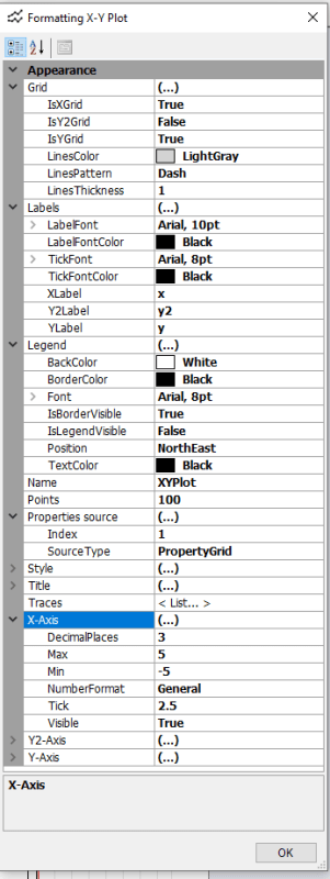

Smath plugins allow dropdowns, radio buttons, check boxes.. all of which are missing from MathCAD Prime. No, combo boxes don't count. Its a small group developing features, but steady.
And of course, I agree with all of your points relating to the advantages of not being owned by *PTC.
The one point that I do concede to MathCAD over SMath is in graphing. But in that regard Maple and Mathematica kick both their pants.
The X-Y plot plugin for Smath is a vast improvement over the default.
No, it isn't Excel or Matlab but at least the charts looks presentable and have a decent UI to drive it.

Thanks for the plugin info, Greg... I don't often use plotting because it is so 'clunky'. I'll take a look at the new plugin.
