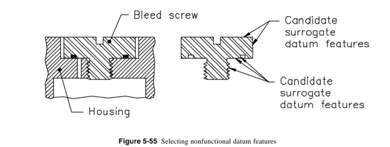

From "Dimensioning and Tolerancing Handbook" by Paul J. Drake:
"5.9.2.3 Surrogate and Temporary Datum Features
Often, a promising candidate for datum feature has all the leadership, breadth, and character we could ever hope for and would get sworn in on the spot if only it weren’t so reclusive or inaccessible. There are plenty of other factors that can render a functional datum feature useless to us. Perhaps it’s an O-ring groove diameter or a screw thread—those are really tough to work with. In such cases, it may be wiser to select a nonfunctional surrogate datum feature, as we’ve done in Fig. 5-55. A prudent designer might choose a broad flange face and a convenient outside diameter for surrogate datum features even though in assembly they contact nothing but air."
There isn't an official word for it because the Y14.5 committee pretends it doesn't exist. Every feature selected as a datum feature is a datum feature by definition. Some are considered "functional" in that they are direct contact surfaces with mating parts the limit the location and orientation variation between them,
The word "surrogate" could have been just removed almost entirely from that description with no loss of information. The title would change to "Candidate and Temporary ..." You can tell that by the example where all the features are called "surrogate." If there is no difference there is no need for a word for that lack of difference.

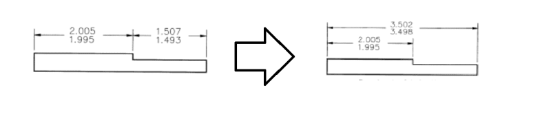

Hello Everyone,
Again thank you for all your answers. As I mentionned earlier, English is not my native language. Maybe I didn't express myself correctly, and wasn't able to convey my question correctly. I will try to better explain if you don't mind.
Let's say that I am NOT the designer of a part, I am one of the different manufacturers of the part. As such, I am not allowed to change the engineeing definition drawing. As I look at the drawing, concidering the tooling I have at hand, I find that I would be better for my process to have a the part dimensionned differently because I can machine the part without removing it from my milling machine. This dimension would only benefit my company, not the other manufacturers of the part. I understand that by doing so, the tolerance will be tighter than necessary, but I am confident in my process and I beleive I can't have a better return on investment by doing so. Obviously, the final inspection will be done per the original drawing, but I need tolerancing that can be checked while the part is still on the milling machine.
I want to basically do the change in the image below. The tolerancing here is not geometrical because the previous professor who just retired was using... well... vintage textbooks [wink]
I am trying to modernize the class before next term. Since I alway worked as a designer I tought this was heresy, but after contacting many people in the industry, they insisted that they used it a lot. Problem is they also speak French... I can't beleive French designers are using something English designers aren't...[wink]
This is simply the concept of preparing a technological process-based part drawing (with dimensions for manufacturing and in-process inspection).

supergee said:
What words would describe this concept in English so I can find documentation on the subject?
Well, I would simply say technological dimensions and tolerances.

Anyway, it's called creating in-process dimensions as targets for manufacturing convenience.
It's technological because it is often within the responsibility of the manufacturing technologist to assign and document these dimensions and tolerances.
