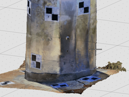

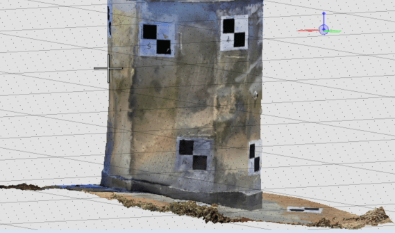

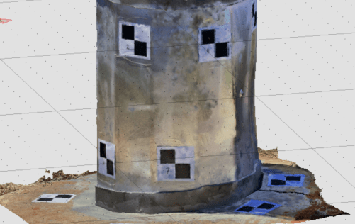

Hi all,
Was wondering if there was any resources on grout filled hollow section?
I have a high consequance of failure, steel power pole that was impacted by a vehicle causing a visible deformation. A buckling analysis indicates a capcity reduction of at least 25%.
The reduction in capcity comes from the deformation inducing sudden changes in the section/stress concentrations, as well as flattening out the stiffners and reducing the section diameter.
Was hoping to grout fill the pole, more to prevent the section buckling rather then any composite action. Would like any understanding of the methodology behind this methodology.

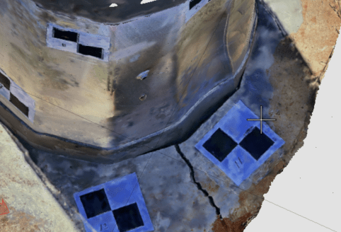

GeorgeTheCivilEngineer the vehicle hit just above the ground line, the damage continues below the ground line. This would need to be exposed, which would reduce the footing capcity, which would then require propping, which will be difficult, given the site. Otherwise, it would work.

My read on this is that the pole has been bashed inwards. As such:
1) The pole is kind of "pre-buckled" in it's current state.
2) Buckling outwards is likely much less of an issue than is further buckling inwards.
3) No bollard or protection setup is likely to address the reduced capacity accruing from the pre-buckling.
I don't feel that the concrete infill is a great strategy for this. Where the pole is pre-buckled, you'll have the potential for some wicked P-Delta action locally tending to further buckle the pre-buckled areas. And, even in tact, I could see the concrete potentially crushing behind those local areas. Or, at the least, proving that the concrete wouldn't crush sounds like an odious undertaking.
The concrete filling of undamaged members to prevent buckling is a different animal in my opinion. There, the geometry of this is still such that it take very little restraining stiffness to get the job done. That kind of goes out the window once you have large deformations backed into the cake.

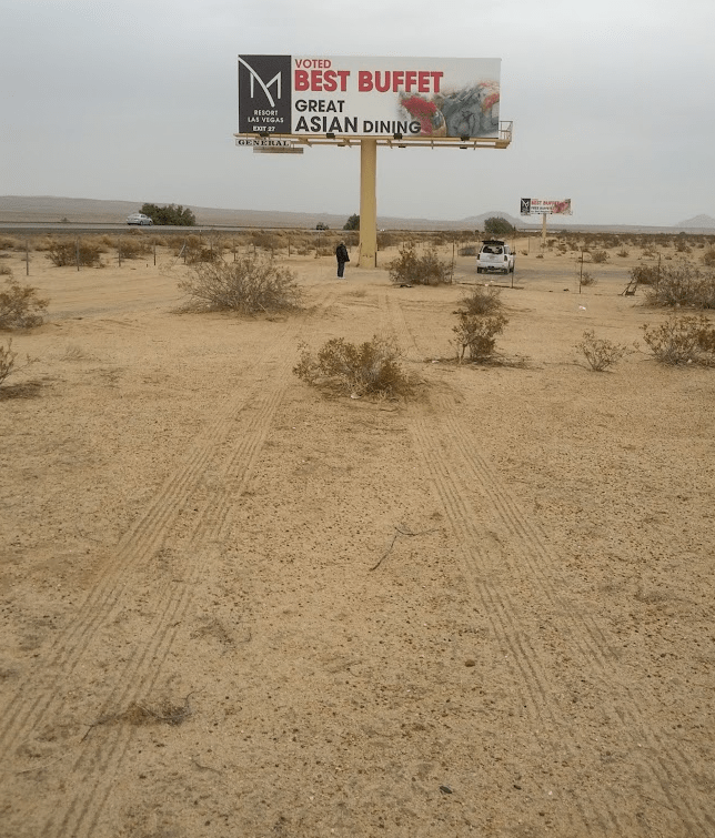

I had a similar question a decade ago here: Damaged Large Pipe Column Repair
Mine was alleged to have been hit by a truck.
azcats - loving the tread marks. They didn't even flinch....
OP - I think KootK covered it well. If you have space to somehow cut this thing open and pump grout in, surely there's some way to shore it up enough to cut out the damaged section and weld in a repair? Or, if it's a straight section (no taper), is there a size up that would 'nest' with the original size? If so, could you cut a piece from some of that stock and fit it around your damaged area and weld it in place, effectively bypassing the damaged section?
PhamENG:
“They didn't even flinch...?” They were actually intent on missing the bushes, so they didn’t hurt them, and didn’t even see the steel sign post.
azcats
Your pole will likely be a lot thicker. This pole is probably about 5mm (not entirely sure), where as your pole is approx 10mm.

KootK - 2) Buckling outwards is likely much less of an issue than is further buckling inwards.
I doubt it could buckle outwards as well. It would increase it's own section properties to do so, so not very likely to happen. There's negligible axial load, so it will be a flexural failure.
KootK - 4) Reinforcing the area with metal and;
Difficult to do, given the shape and the 75mm or so of displacement. Well difficult to do, and actually provide the adequate support.
Additionally the damage continues past the ground line (still dispalced about 35mm at ground line).

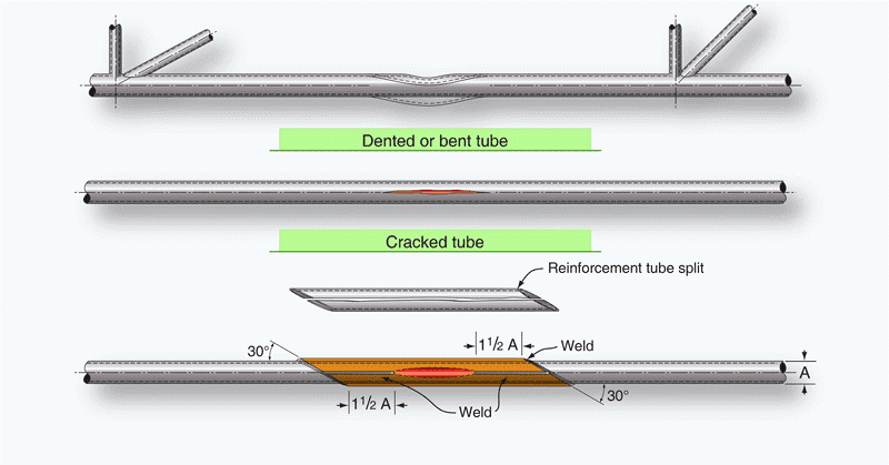

The pictures you have posted implies the wall thk. of the pipe should be around 1/4 in.
I will suggest you , the use of split sleeve reinforcement after fixing the pole . The split sleeve may be made from plate or pipe using the same material.
One of the pictures i have found at web search for SPLIT SLEEVE REINFORCEMENT ,
