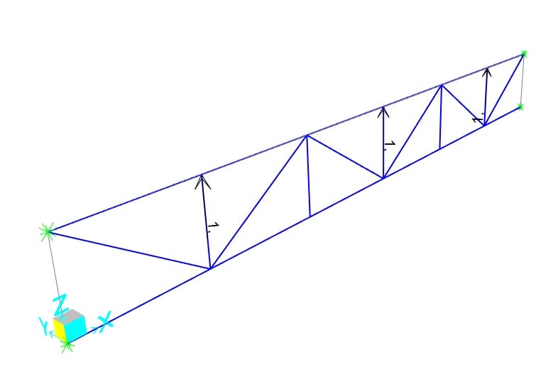

I am trying to understand buckling factor analysis results. I've made this 11m truss and considered both top and bottom chords will be conected to a column. I have considered translation in all directions as fixed and rotation in the x axis restricted too. My analysis is made with a self weight Load and three uplift loads.

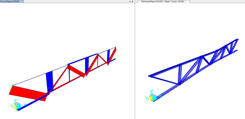

For the results of the first mode I have this
Buckling factor of : -53.542
From my understandment, what this means is that for this mode buckling would be based on reverse loading.
Then I have the second mode:
Buckling factor of : 162.3229
And the compression on the bottom chord is: 0,25kN
This means that for my bottom chord the Critical buckling load Ne is equal to: 0,25*162,3229 = 40kN
I would like to know if my understandment of those factors are at the right direction or if I am missing something.

Your load pattern has three 1.0 kN (kip?) upward loads. The -53.5 factor means that SAP2000 thinks buckling will occur when there are three 53.5 kN loads pointed downward. That's consistent with your third figure which shows the top chord buckling laterally.
What is your estimate of the chord axial force that would cause the chord to buckle? it should be straightforward to estimate with a manual calculation. With this problem, I would expect the top chord to buckle about the vertical axis at approximately the Euler buckling load. It's "critical" (ha) to come up with some way to verify what SAP2000 is giving you.
