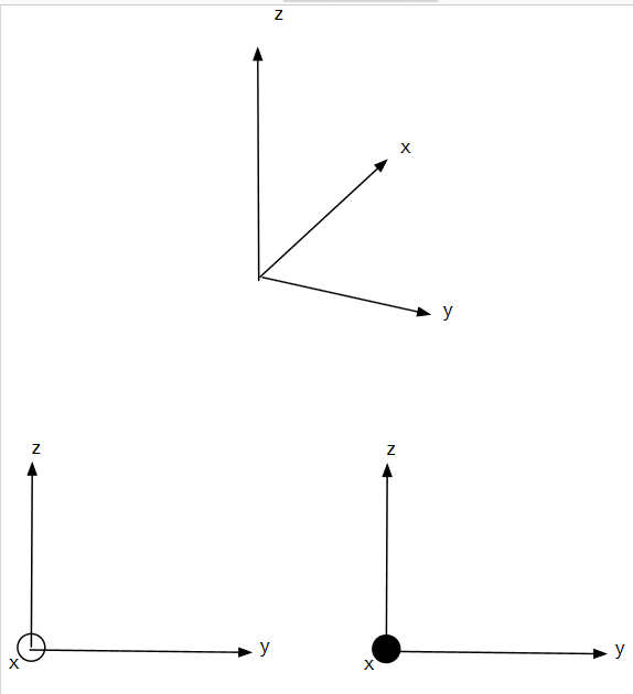

Hopefully you mean z. Into the paper is a x surrounded by a circle, out of the paper is a circle with a dot in it. It's an arrow with a conical head and four flights.
Cheers
Greg Locock
I agree entirely with Greg, but a non-Australian confirmation might be useful.
Thanks for the quick replies.
It enables me to read the data correctly where a + or - can make a serious difference [bigsmile]
Stefan
Same dot and X in US. OP - make sure you use the right hand rule for the z axis direction.
to save downloading:
Also, that appears to be a left-hand rule coordinate system.
Typically choosing right-hand or left-hand makes the direction obvious. You can choose whatever convention you like for though the circle-X and circle-dot seem familiar.
I've only ever heard of left hand rule for smoke doctors, the mechanical world seems to be right hand rule.
Cheers
Greg Locock
As a mollydooker, I feel allowed to say that I find the use of left-handed axis systems a bit sinister.
Left hand is used in computer graphics - XY plane is screen front from lower left corner, positive Z into the screen so all values are positive for visible objects.
3D... I usually use a right hand coord system... it would be in the -x direction, and I'd show it as a dot; I think that's the international accepted useage. [pipe]

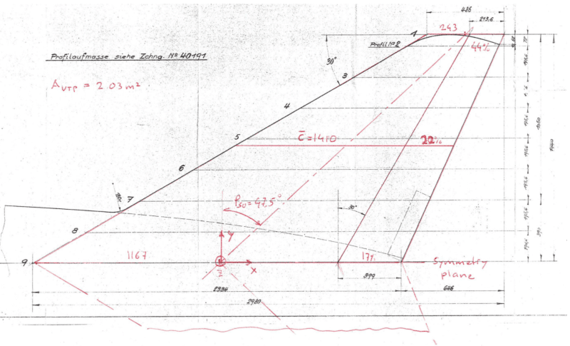

This is what the sketch looks where I need to figure out the direction of Z.
So this appears to be 'out if the paper'.
That looks like a horizontal stabilizer. Most aviation is
said:
The coordinate system convention used for most vehicles, including aircraft and automobiles, is based on an XYZ system originally developed for ships and boats. The X-axis of this system is positive pointing aft and is typically called the fuselage station (FS) in the case of an aircraft. The Z-axis is positive pointing upward and is known as the water line (WL). To complete a right-handed coordinate system, the Y-axis is positive pointing along the plane's right wing. The Y-axis is usually called the butt line (BL) but is sometimes referred to as the wing station (WS) as well. The latter name is probably less common since it can be confusing for military aircraft where pylons and other hardpoints are often called weapon stations.
Yup, that's right hand rule. Curl your right hand into a fist, your fingers point from x to y and your thumb points along the Z+ axis. Some of us might visualise this with a corkscrew.
