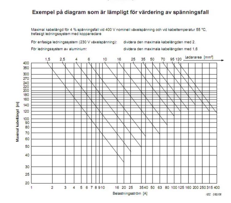

Could you please help me to understand if there are any standards that states the Coverage area for Convenience 230V and Welding 415V outlets?
I just want to know how many meters an 230V Socket can cover and How many meters 415V welding outlet can cover?
Based on my past experience we have followed that the 230V outlet can cover 10m radius and 415V welding outlet can cover 30m radius. Please share your experience and standards if any. Thanks.
Not sure exactly what you are asking for?
But if you have 1 phase + N + PE > 230VAC then 2 phases or 3 phase +N +PE it should be 400 VAC not 415V?
If the question is how long a cable can be in each case it depends on the distance between the fuse and the effect source, the effect used, type of fuss and the cable area of the cables used.
This is SE standard so you need to check if this complies where you are too.
But the basic principle should be the same.
The table is for 400VAC and copper cable, cable temp 55C.
If you have 230VAC you dived the the length with 2 for the same load current (A) and if you use aluminum with 1,6.

2. Mr. RedSnake states "....If the question is how long a cable can be in each case it depends on the distance between the fuse and the effect source, the effect used, type of fuss and the cable area of the cables used." is basic EE.
3. In general:
(a) 1-phase (230V) welders are of lower rating than a 3-phase (400V).
(b) if both welders are of the same rating; a 3-phase (400V) welder draws lower current. Therefore: (i) smaller conductor size for the same distance, or (ii) longer distance for the same conductor size.
(c) What is important is the voltage at the welder input terminals when the equipment is loaded at the rated capacity. A voltage-drop of 5% would be fine. If excessive, either increase the conductor size or shorten the distance, or both.
