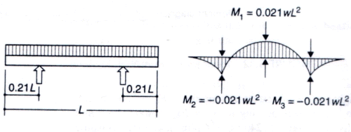

Assume two lift points can be located anywhere along the top chord, not just at truss panel points.
Maximum stability is obtained when beam/truss bending stress is minimum.
To calculate minimum bending stress:
Magnitude of negative moment at Lift Point 1 = Magnitude of negative moment at Lift Point 2 = Magnitude of positive moment in Center Span.
For a uniformly symmetrical member with constant structural properties along it's length (e.g. steel "W" shape or square concrete pile) calculation of optimum lift points is straight forward (both cantilever lengths approximately 21% of total length)
A truss, such as the image in the original post, is not necessarily uniformly symmetrical and may not have constant structural properties along it's length. Calculating the optimum two lift point locations (for minimum bending moment in the entire truss) is more of a challenge.
Using any lift locations, except the two optimum ones, compromises the member's maximum stability.

SRE: "Assume two lift points can be located anywhere along the top chord, not just at truss panel points."
Besides, in the OP's example photo the truss appears to be lifted at the second panel point (of eleven).
Would lifting at the first or third panel points be a better compromise?
He may not consider that location of the lift points influences stability... unless someone points it out... which is what I have done, and say so:
SRE: "Using any lift locations, except the two optimum ones, compromises the member's maximum stability."
