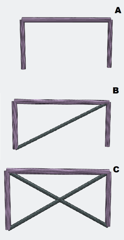

Thanks for the comments. Interresting commentary there regarding the values "may seem to be conflicting or confusing". Maybe more context would be helpful.
Image below shows 3 variation of bay and bracing (A) no Bracing (B) one-way diagonal and (C) two-way diagonal.
My question is whether (B) and (C) can both be considered 'Symetrically braced". Is there a clear cut definition of what symetrically braced is?
In B, is there just the once brace, or are there actually braces like in C but you're only showing the one acting in tension?
I would say C, with tension-only braces, meets the "symmetrically braced". You'd have to look at the definitions more closely on B (you might have symmetry about a digaonal, for example, and I'm not sure if that would count.)
JStephen
B is just one brace. Seems SWCOmposite comment is pretty apparent, no symetry in X or Y.
And these wouldnt be tention or compression braces, say round pipe as shown

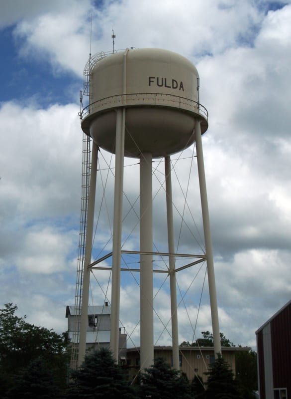

The picture below depicts the symmetrically , X braced , tension only braced tower.. Notice that , steel rods are used for X bracing which can buckle easily if experience compression force.
Another picture , ASCE 7-16 FIGURE C15.1-1 Steel multilegged water tower
