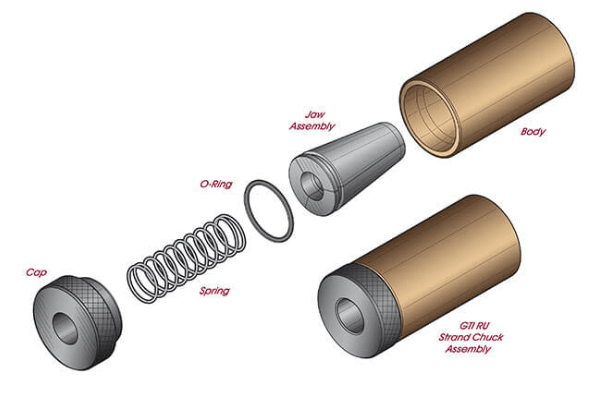

An alterative to achieve a similar result - develop stem bearing reinforcement - would be to use the same plate with a 9/16" dia hole and install a strand barrel chuck over the strand that bears on the new plate. Essentially a passive anchorage.
Could you amend the holed plate to a steel 'shoe' with a 9/16" hole, that is epoxied to the end/underside/web of the DT to provide increased bearing stress capacity, with the barrel chuck engaged over the strand, bearing on the plate/shoe?

@Ingenuity A chuck could not be applied to the projecting strand for two reasons.
1. there is only approximately 1" of space between the end of the stem and the bearing wall which does not provide enough room to install a chuck.
2. There needs to be a minimum of 1/4" of elongation in the strand for chuck take-up. Without that take-up distance of elongation, the chuck jaw assembly would just be loose and do nothing.
