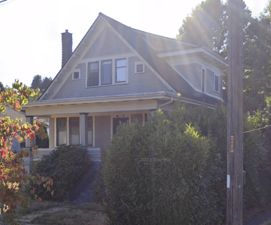

We used to own this house in Seattle:
House was built in 1914. It needed a new roof, and old roofing needed be removed; well, when the roofing contractor tore off the roof they found two! layers of asphalt shingles on top of the original cedar shake roofing. There was an unused chimney in the center of the house for the original coal furnace in the basement and wood stove in the kitchen. We had the roofers remove the chimney below the roof line. When re-roofing was all done I go up into the attic to start removing the rest of the chimney. Looking up at the rafters and framing, I have no idea how that roof stayed up (particularly when a couple of years before we had a big snow storm followed by rain which put a huge layer of wet snow/ice on the roof) as the rafters are 2x4's, many of which did not connect to the ridge board, and many of which had large splits sometimes completely severing the rafter; there wasn't much in the way of cross ties or bracing. The flat-ish dormer areas on the sides were particularly concerning. But I figured, well, the roofing weight is now a lot less than previously, and it held up somehow with a foot of ice on the old roof, so why worry. Probably the fact that the framing was all old growth Douglas fir helped a lot.
Contractor cut out a tension rod that supported a 30' long 6-ply 2x10 beam. That beam supported 2 additional stories and a roof.
He said the floor deflected like crazy when they cut the rods. I'm amazed the whole building didn't collapse.
