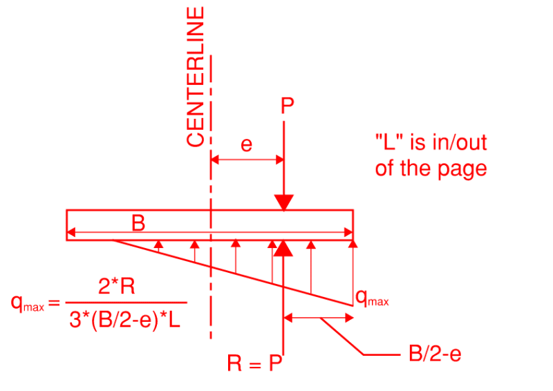

A heater structure installed in 1967 at a refinery needs to be updated, which will increase the dead load slightly and increase the height somewhat. It's around 150 feet tall including the 70 foot stack, so wind loading is significant. They'd like to verify that the foundation is adequate. I have the records indicating what wind loads were imposed then according to UBC, but I don't have footing design notes. My initial analysis indicates that the eccentricity M/P puts the resultant force well outside of the middle third of the foundation, (and our foundation design software says the same thing). Is there a load factor that should be applied to wind loads before computing eccentricity?
The dead load is 422 kips, live load is 36 kips, total shear from wind 60 kips, moment at foundation base from wind is 3600 ft-k. Foundation is 20' x 36' x 4.5' with no soil on it. The footing dimension responsible for resisting the moment is the 20'. The soil net bearing capacity is 2100 psf.
I'd like to be able to prove that the foundation WAS adequate according to wind loading (verified UBC 1967) and foundation design standards of that time - before I try to update to today's loadings and design standards, but everything I try ends up failing due to wind loads. What am I missing?

Thanks for your input. I have looked at the Factor of Safety for overturning, and feel certain that the wind can't tip the structure/foundation over. Structure dead weight 422k, foundation weight 486k, overturning moment at foundation base 3592 ft-k. For simplicity, loads centered on 20 foot dimension of footing, resisting moment is 9080 ft-k. So F.S. is 9080/3592 = 2.5. So this makes me comfortable that the wind loads of 1966 can't tip it over. (SlideRuleEra: The actual heater structure is supported on (12) 18" x 18" concrete columns that are 7 feet tall, each with 3/4" base plates, (4) 1 1/8" diameter anchor bolts - so I think anchorage to foundation should be adequate).
My Civil Engineering Reference Manual the method to compute service soil pressure qs = Ps/Af + soil dens x footing thickness + soil on top +/- (Ms x B/2)/I. result should be less than allowable soil pressure.
The result I find is that using the moment from wind takes soil pressure beyond what is allowable - by about 30%. This formula is using unfactored loads, and is intended to determine the footing area.
I found elsewhere that the service load Ps is DL + LL. Would service moment Ms include moment from wind loading?
You have described everything but how you calculated wind load, so I cannot tell if factors should be used or not. It would be helpful to see exactly how you have calculated the wind load and its overturning moment. You have apparently taken flat wind load on a flat projection. Are the heater and stack composed of flat surfaces? Is the stack not round? Have you applied appropriate shape factors?

It appears that your eccentricity is outside of the kern of the foundation. If you're getting a negative bearing pressure, the P/A +/- M/S model is no longer valid. Essentially, you're going to have an increased positive pressure, because static equilibrium needs to be maintained. See the image below. If you're doing analysis on a "per unit length" basis, omit the L value in the q[sub]max[/sub] equation.
I don't see anything wrong with the wind load calcs.
Yes, apply the same factors for soil bearing calculations.
It would appear that your soil bearing calculation program forgot to include the case where eccentricity uplifts the upwind side of the foundation, as wineladv mentions, however the calculation is simple enough to do by hand. You can follow the calculation he shows there. That is also probably going to be your critical case for control of overturning. Righting moment / overturning moment must be greater than 1.5

Agree with windlandv's illustration. In this your case, it's not a question of calculating q[sub]max[/sub]... based on what you have told us, q[sub]max[/sub] is known and equals to 2100 PSF (soil net bearing capacity). Using that value, back figure eccentricity. Then using that eccentricity back figure resisting moment. In 1967, safety factor was whatever the Engineer considered appropriate, not necessarily 1.5.

Thanks again. Further investigation reveals that the soils report says the allowable pressure is 2900 psf when wind load is present. If I use your approach and determine eccentricity by using the allowable pressure, the eccentricity falls within the kern. I'm not understanding how that helps. If we know the moment and the axial load it seems eccentricity of forces determines the pressure on soil, not the other way around.

It helps because the bearing pressure, magnitude of load, and eccentricity are related variables. The equation that winelandv presented describes how these variables are mathematically tied together. Change one, and one or more of the other variables must change to balance the equation. If you know allowable bearing pressure... now we are told it is 2900 PSF, and you know load magnitude, then eccentricity for those values can be accurately calculated.
Using that eccentricity, magnitude of the resisting moment (that does not cause soil overload) can be accurately found.
And another issue, to me, the calcs are NOT about "helping" or trying to get the structure to "pass". The calcs are about accurately finding out what is going on with the structure... then you can reliably "deal" with whatever the numbers reveal.
1503--44 - I'll defer to your experience. I know that many safety factors were historically used for decades before being formally incorporated into codes. Since the OP is referring to UBC 1967, I wanted to point out (to the best of knowledge) that UBC 1967 does not require a specific safety factor.
When eccentricity falls within the "Kern region", q_min is >= 0 and is at the upwind edge of the footing. There is no uplift of the footing; the soil below the footing is under compression at all points.
When outside of the Kern, q=0 at some point on the footing, the pressure diagram appears as shown in wineladv's diagram. The footing experiences uplift in the region everywhere q =0.

Again, I appreciate all of your perspectives. Sliderule, it is useful information to reverse engineer and determine the magnitude of resisting moment that doesn't cause soil overload, but we can't control the wind! We will need to inform the client that if we were designing the foundation by today's standards we'd make it bigger; so that there's no uplift, reaction falls within the middle third, doesn't overload the soil, etc. Given that the structure SEEMS stable and updating the heater only pushes the soil overload another 5% over the reported allowable soil pressure, maybe they'll decide to live with that risk. I think that catastrophic failure is VERY unlikely. I assume failure would be slow like the leaning tower of Pisa, and action would be taken when/if a problem is observed.

winelandv, thanks for your input. Would you consider the weight of the footing as part of P (=R) in determining eccentricity?
