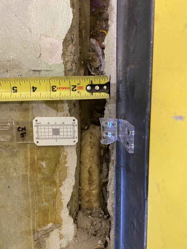

This is a crack monitor that was adhered to a concrete slab with hot glue. It held pretty well considering.
I believe the glue can be removed later with rubbing alcohol and heat.
