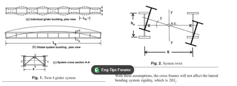

In bridge superstructures, to be considered bracing members, the secondary 'beams' (AKA diaphragms) have to meet the slenderness requirements (r > L/140) so they don't buckle in the weak direction, and they have to be more than 1/2 the depth of the girder.

I disagree. This system is generally conceived of as torsional or "roll beam" bracing which does not require lateral restraint. Twin girder diaphragm bracing in bridges is sort of an extreme version of this. Perhaps you and Lomarandil are envisioning beams that run over top of the girders?
Lomarandil said:
The concern is that without that "hard point", each of the primary beams could roll over in the same direction, and the bracing just goes with it.
For the same reason that I mentioned above, I believe that this is also incorrect. The "same direction" thing is a phenomenon of translational bracing, not torsional bracing.

That's right, even in the absence of decking. Done by the book:
1) The girder to beam connection should be at least 0.6 x the depth of the girder and;
2) The girder to beam connection should be capable of a nominal amount of moment transfer. Shear tabs, end plates, and clip angles are commonly deemed appropriate.
3) There's an AISC section that dictates the strength and stiffness that the roll beams out to have in order to perform the bracing function.
KootK, you're describing what I meant with my first option. Torsional bracing.
(Sorry if my wording there was overly pessimistic, I've been dealing with a rash of engineers telling me "my beam is connected to X, therefore it must be braced". Not necessarily!)
