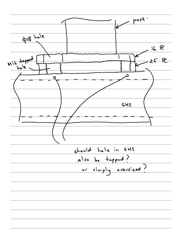

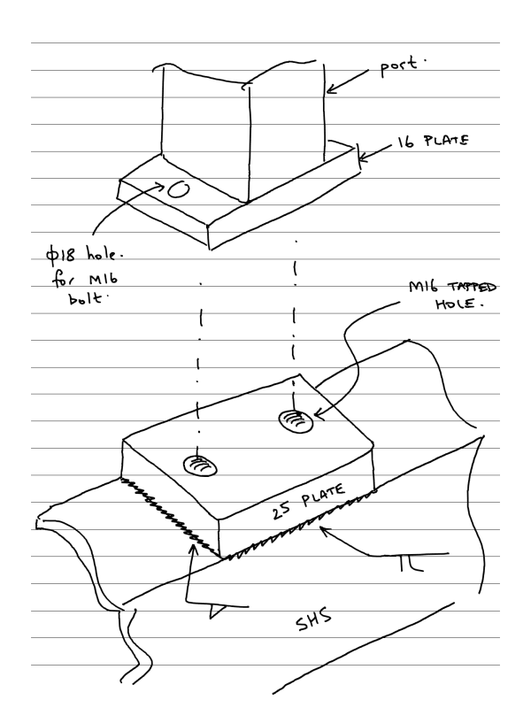

Please refer to my sketches below.
I have a handrail post that will bolt onto a baseplate, which is welded to a square hollow section.
I am wondering what the typical process of fabricating this would be? Will the baseplate be holed and tapped before welding onto the SHS, or welded first and then holed and tapped?
If the former, I suppose I would just allow for some holes in the top of the SHS to allow the bolts to pass through, perhaps ~20 or 24 diameter.
If the latter, is there any issue with tapping through two separate pieces of steel?
Note that the 25 thick plate alone provides enough thread engagement in this case, so I am not relying on any additional thread in the SHS.
In my experience there is no huge issue tapping through two laminated plates. I'd weld the plate first. Typically this would be profile(laser) cut with the hole already in place. (though I believe there is some heat hardnening here that makes tapping harder).
The plate would then be welded to the SHS. Then after that you'd drill through the SHS and then tap. If the item is being galvanized then you need to retap the holes afterwards. Like you said with a 25mm plate and the right bolt length you probably don't need the SHS tapped.

I avoid tapping through two plies - I would provide a clearance hole through the HSS and field weld the shop-tapped plate.

dvd, thanks for the reply, I'm leaning towards the clearance hole option since I think this is more likely how they will fabricate it. I've not really dealt with Hollo-bolts before but I will check it out.
If tapping the holes, the 25mm plate should be welded to the HSS before drilling and tapping. The use of the Hollo bolt is good. In these environs the 16mm plate (or more likely a 10mm plate) would simply be field welded to the HSS, or just the post itself.

In general, most fabricators would be processing the plate and the HSS on different machines. Most of them would not want to drill and tap the holes after welding together. Because of this, it would be a good idea to have larger clearance holes in the HSS and only tap the plate - this will allow for fabrication and fit-up tolerances.
