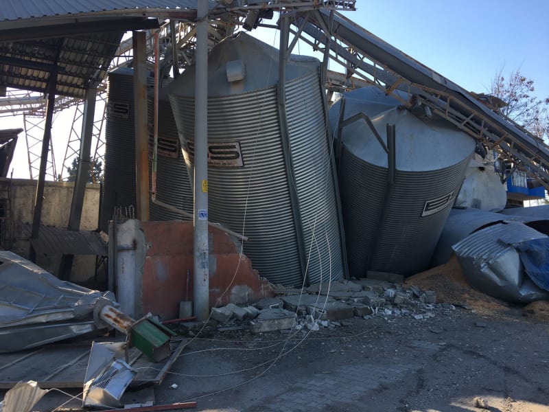

Dear Friends,
Field observations along with the surface manifestations of the 7.7 and 7.6 Magnitude Earthquakes in Kahramanmaraş, Pazarcı.
this incident give us a small picture of what will be happen in Oil refineries / chemical processing plants !!!!
Is there a unified [like IBC] industrial/building seismic code [mandatory] ?
especially in elevated steel structures like mast, stack, chimney ..etc
Any referend textbook, codes, or guidelines are appreciated.
Any strengthening/reinforcing technologies are most appreciated.

Tall stacks are typically wind governed even in high seismic areas.
The best starting points are likely the asce guidelines for design and retrofit of petrochemical facilities.
A lot of that has also been incorporated into asce 7 at this point.
Past that it depends on the equipment. Some standards have really good treatments like API 650. Others are irritatingly silent.
Also, I don't think this is a question of good vs bad countries. Western countries aren't great at this either.
