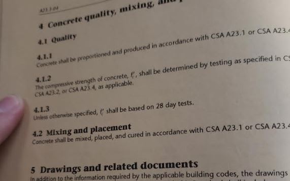

Other then that I found a few references maybe worth considering.

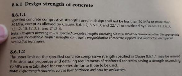

From CSA A23.3 we have
I'm not sure if there's a better clause delineating what CSA considers high-strength vs normal strength. But based on the following I'd think it would be 50 MPa (7200 PSI) or greater since that's when it says to check into QC thoroughly. Also seems to jibe with this.

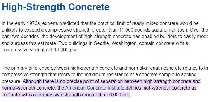

The PCA seem to list high-strength concrete as anything greater than 6000 PSI (meaning your 6000 PSI is technically normal strength). More info on 6000 PSI threshold here.
