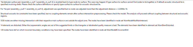

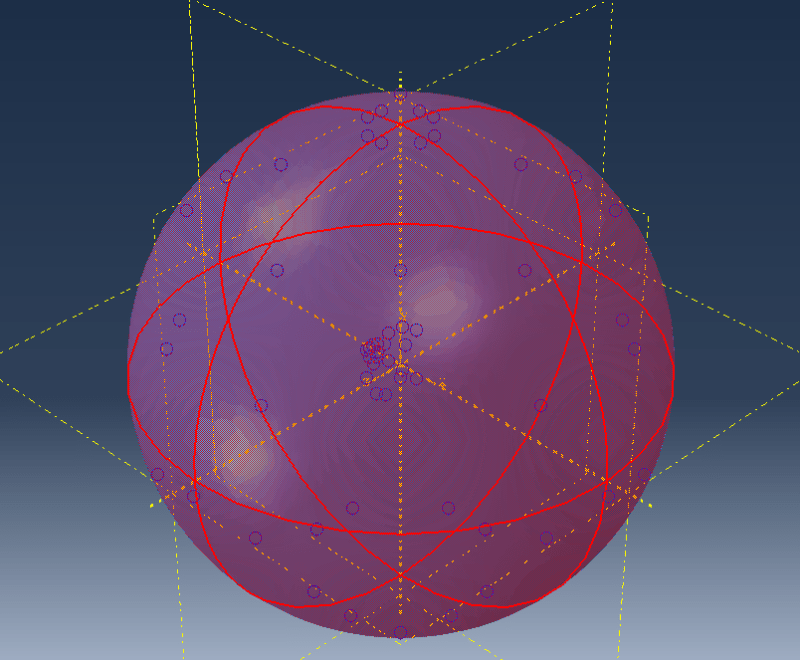

I am new to ABAQUS. I have some previous experience in Ansys Structural FEA. I am trying to perform acoustic-structural analysis to find sound proapgation in air. I looked it up in the manual and followed the instructions but the results with the TIE constraints were not what I was hoping for. Many of the elements don't get contrained to each other and the analysis runs without coupling the acoustic and structural media. I am using a spherical air medium as the acoustic medium and a semi-spherical hollow steel object of 1cm thickness as the solid medium. I have tried using the same mesh parameters on both the media but they still are not coupled. I am running a modal analysis and steady state dynamic (Modal) on the system and the values I receive are probably for individual interactions of the media. I want to find the POR in the air medium due to a force acting on the solid medium.
Please suggest a solution to this problem so the the two media can be coupled together. I am using the air medium as the master and the solid surface as the slave.
I have attached the mesh models of the media here.

The STRAINFREE output variable, together with internally generated node sets (WarnNodeMissMainIntersect and WarnNodeAdjust) can help you identify problematic regions and apply proper changes. Also, keep in mind that the mesh sizes (and thus also main/secondary surface assignments) have to be selected based on wave speeds in such analyses.
I changed the mesh size according to the wavelength and these are the errors I get.
What about the main/secondary surface assignment ? Did you try inverting it ? The rule is that the secondary surface should belong to the part with a more refined mesh. As a last resort, you could use ASI (acoustic-structural interface) elements but it's generally not recommended and it should be possible to make tie constraint work for such simple geometry.

If i select surface of the air domain does it take the outer surface or the surfaces of the nodes? If it does how will it couple with the surface of the solid domain since the solid is within the air?
Can you share the file or at least a screenshot showing the cross-section of both parts assembled together, rendered with different colors (Color Code --> Part instances) ? There should be a cavity for the solid body in the fluid domain.
Ohh. I have been trying to couple a solid air domain to the solid domain. I didn't make a cavity for the solid. Where is the color code option?
It can be found on the top toolbar - it's a drop-down list next to the color palette icon. There you can select the criterion for coloring.
