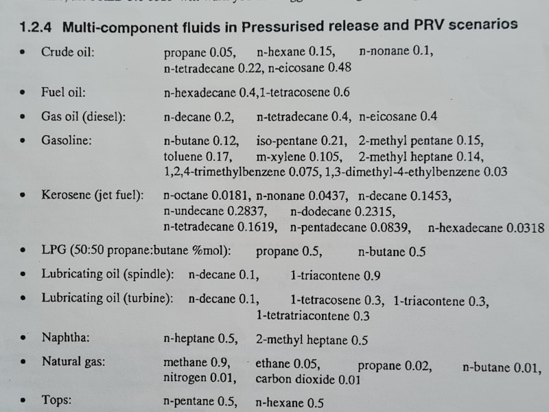

I used to follow this 2001 table from Shell FRED software, unless I had more specific data, then would group the largest% components similar to georgeverghese reply. The fire modeling results for a specific configuration of pool fire or jet fire don't vary much by specific component of the heavier fractions.

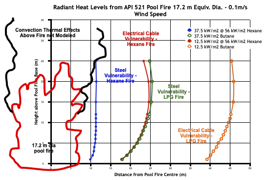

You bet it right on the nail ProSafPlant1 ! As we would like to come up with recommenfations regarding equipment spacing and fireproofing spec. I will run the software in the light of your remarks (standalone model for pool fire, downward relase orientation).
Thank you again.
Billdoor, you might find this plotting of PHAST data for fireproofing interesting:
This will be of a good help.
Thanks a lot ProSafPlant1 !

ProSafPlant1 could you possibly give me the reference from which SHELL FRED document you got that table from ill very much appreciate it.

To put things into contexte, im working on a refinery safety study, these type of studies require consequence modelling of the differente phenomenas that could happen (fires, explosions ..etc.)
so in order to do that i need to model ther different refining products(naphtha, crude oil, kerosene ..etc), having an exact idea of the composition isn't feasible so i was looking for a document that gives a simple and conservatif composition of these products.
ProSafPlant1 gave a very interesting screen shot and im looking for the full document
Thank you again

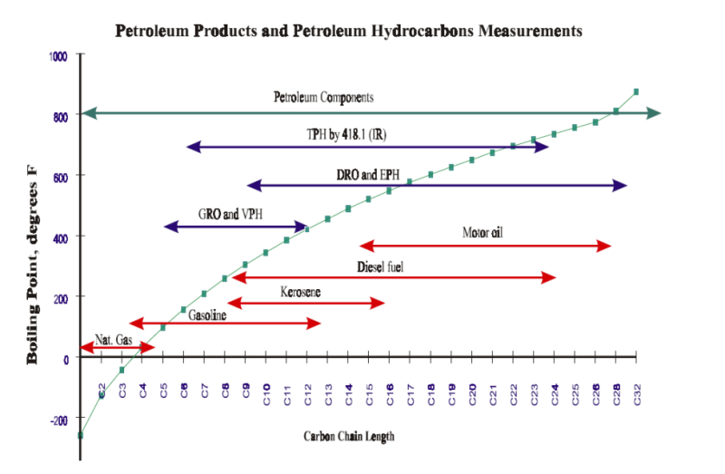

Ranges of carbon number compounds of the various products
[URL unfurl="true"]https://res.cloudinary.com/engineering-com/image/upload/v1689253950/tips/products_carbon_number_range_c5yryf.bmp[/url]
consider the ranges defined by the arrows shown on the composition graph to represent a normal curve of C_no compositions from min to max carbon numbers.
like this
The C_no compounds

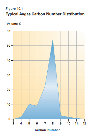

~Atttached file shows various chromograph compound compositions for several products
[URL unfurl="true"]https://res.cloudinary.com/engineering-com/image/upload/v1689254916/tips/aviation_gasoline_vzaftu.bmp[/url]
is that what you needed?
