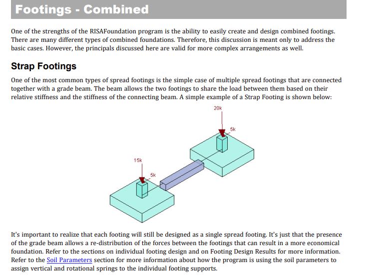

WinelandV - Unfortunately, in RISA foundation, this is the only way to model strap beams/grade beams between columns. Just generally drawing in a beam element between columns does not redistribute the column forces. I'm starting to think deep foundations may be the only option for this building.
@Delmarva_Struct:
"Unfortunately, in RISA foundation, this is the only way to model strap beams/grade beams between columns." I don't believe this is an accurate statement see below image taken from the manual:
For strap beams you need to make sure the beam is stiff enough to redistribute the pressure and the beam should not be supported along it's length by soil springs.
