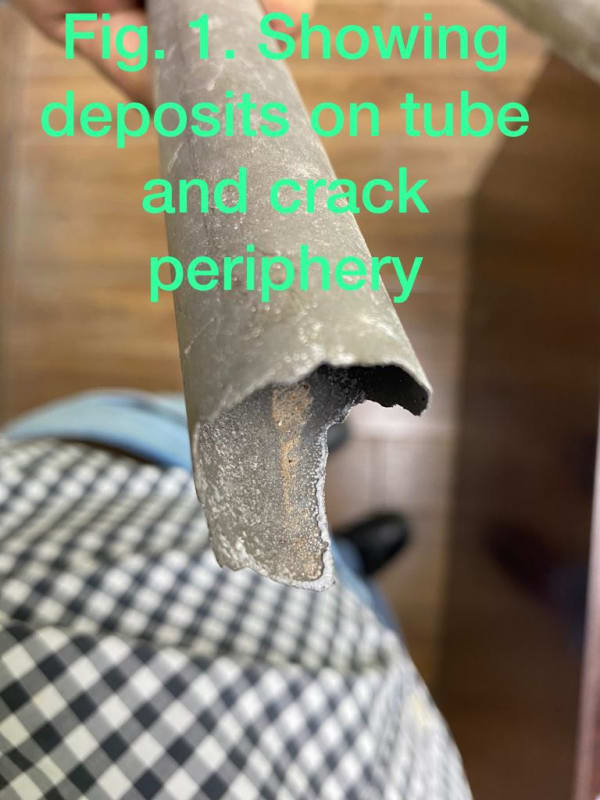

Dear All,
We have a vertical heat exchanger that comprises of seven boxes. These boxes are stacked over each other.
The tubes are made of Titanium ASTM B338 Grade 2 and boxes are cast iron. The life of tubes is approximately five years and we would like to choose material that will provide longer life.
Operation:
The function of this heat exchanger is to cool the gases and heat the liquid.
The gases enter from bottom and exit at top i.e. the seventh box. The gases temperature at entry is 100C plus and leave at 60C plus.
Composition of gas:
Ammonia NH3 = 0.402 kg/m3
Carbon Dioxide CO2: 0.255 kg/m3
Water H2O: 0.128 kg/m3
Hydrogen Sulfde H2S: 0.003
The fluid in boxes are different.
One fluid liqour enters the 2nd box and exits from 1st box.
Second fluid enters the 5th box and exists from 3rd box.
In 6th and 7th box cooling water is used.
Fluid composition of 1-5 boxes is similar.
NH3: 2.4-2.8%
NaCl: 6.8-8.1%
NH4Cl: 16.2-18.2%
CO2: 4.2-5.3%
The life of 1-3 boxes is the least, this is probably due to higher temperature of gases in this region. The tubes thin out and mostly at the u-bends. So, erosion has to play a part as well. Tube OD 1inch and thickness 20 SWG = 0.914mm.
So how long do the other boxes last? Are they good for 10 years?

Thanks for your replies. The exact damage mode I haven’t not witnessed myself but from information gathered, the tubes leak at the bends. I have been studying and found that gr 2 is susceptible to under deposit crevice condition in the operating condition we are using and have recommended grade 12 instead. Price of which is 2x. This corrosion rate increases with temperature. We are facing issues in the boxes where temperature is higher.

Apologies for such delayed response. Responding to EdStainless PH of fluid in tube is 7.5. Discussion on deposits below.
Now that one of the faulty exchanger boxes got replaced, I got a chance to look into the failed tubes. However, due to brittle nature and small thickness it is difficult to tell where the tube actually leaked. There are several cracked regions however. Following are the observations:
1. Deposits can be observed on the internal surface of tube of whitish and brownish nature.
2. No leak points at bends found. Instead cracking found at different region of tubes.
3. The thickness of tube has decreased significantly. I took thickness at different areas and it was around 0.3-0.5mm. Original thickness in around 1 mm.
Based on previous online review I did, I found that Grade 12 has better performance compared to grade 2 in Brine environment.
Have you considered bimetallic tubes such as Omegabond which have Titanium as substrate and Zirconium as top layer?
No we haven't explored it. We don't to modify the material as it will affect performance of heat exchanger.
A professional failure analysis is needed. You have a problem if Ti type 2 is corroding. Hydriding under certain conditions is one of the few failures we have seen in
ti- 2 . The other is accidental exposure to HF.
erosion and fatigue.
All Ti alloys are poor at resisting both of these.
Hire someone to analyze vibration in these units.
I would guess that you are running high flow velocities, and the deposits are causing the erosion.
Find out what the deposits are.
Thank you EdStainless, if it were erosion shouldn't it have affected the bends more?
In our scenario, the bends are in better condition compared to the straight portion.
Not usually, the added turbulence at the entrance/exit is where erosion is most oftend an issue.
