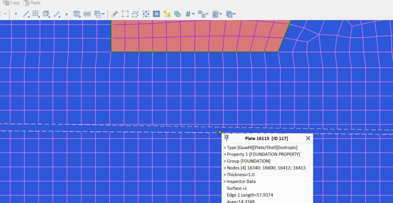

If you set the plate boundary line colour to "Group" (right click the plate icon on the left of the display) it shows the blue plate boundaries more clearly, and you can see there is something wrong with the model. Point at a plate and press shift to highlight the plate edge and display element information.
I suggest fixing the plates, run Tools-Clean, then run a linear analysis with comments displayed.

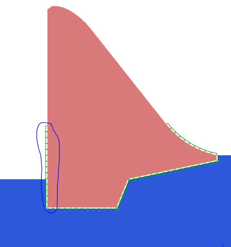

I saw the meshing is not proper and there is a slight gap between meshed elements. I tried to clean the model but unfortunately, It's not working. I tried to reexport the model from Revit by providing a 10mm gap between the surface of the Dam and the rock bed and tried to connect those surfaces through attachments (as shown in the attached pic)- this seems to be working for the moment. Hopefully that should sustain the other load configurations
