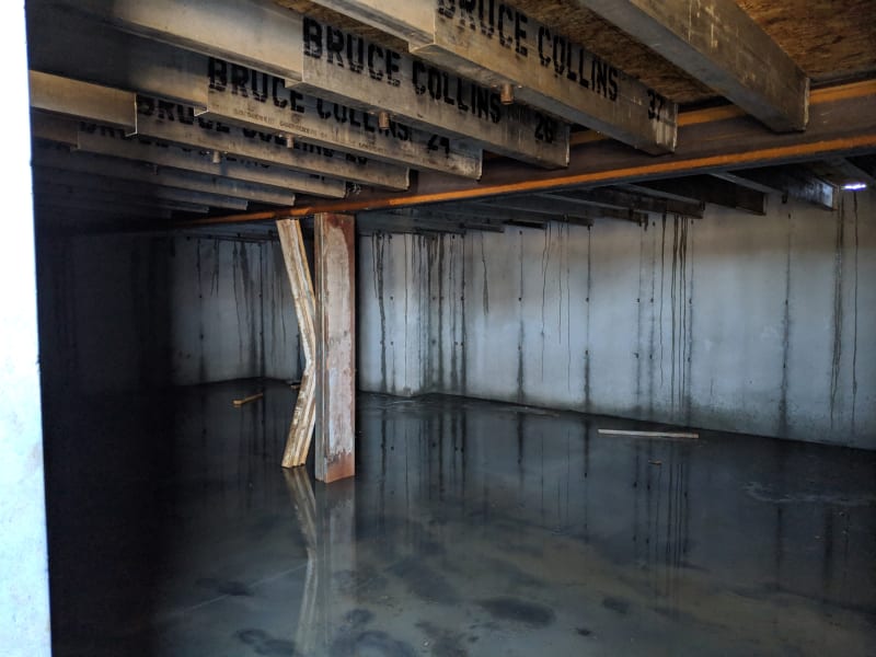

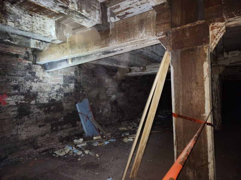

Not sure this wood failure is super rare, but the structure itself was noteworthy. It was an old refrigerated warehouse being converted to self storage. The current owners were just opening the worm can and finding many things like this.
That right there is a mess. Looks like pretty old framing. Don't recall I've ever seen steel angle ledgers before like that on every joist/beam. Always interesting to see the million different ways wood to wood connections were made prior to hangers, especially since most are failed or failing in some capacity.

I've never seen anything like it either. Above that floor platform all the columns are solid sawn timber in a 14'x14' grid. The biggest were 20"x20" with 1" thick steel collars at the top. The building was in terrible shape and the moisture condition within the multi-wythe brick pockets had a catastrophic effect over the years. The photo below shows one of ~20 pocketed beams that were crushing and shearing at the wall. I ultimately had to walk away from the job--the contractor and current EOR for the repurposing were at severe odds and the contractor thought he could bring in a new engineer to take over... No, thank you!

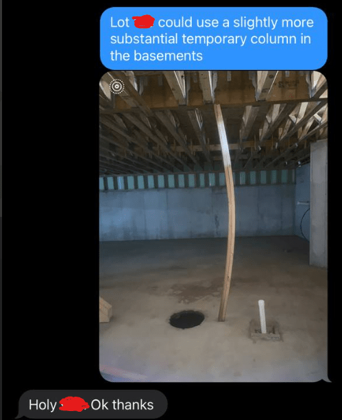

This one always makes me laugh--text message conversation between me and the site superintendent for a new neighborhood development. The permanent steel column hadn't arrived yet while I was doing framing inspections.

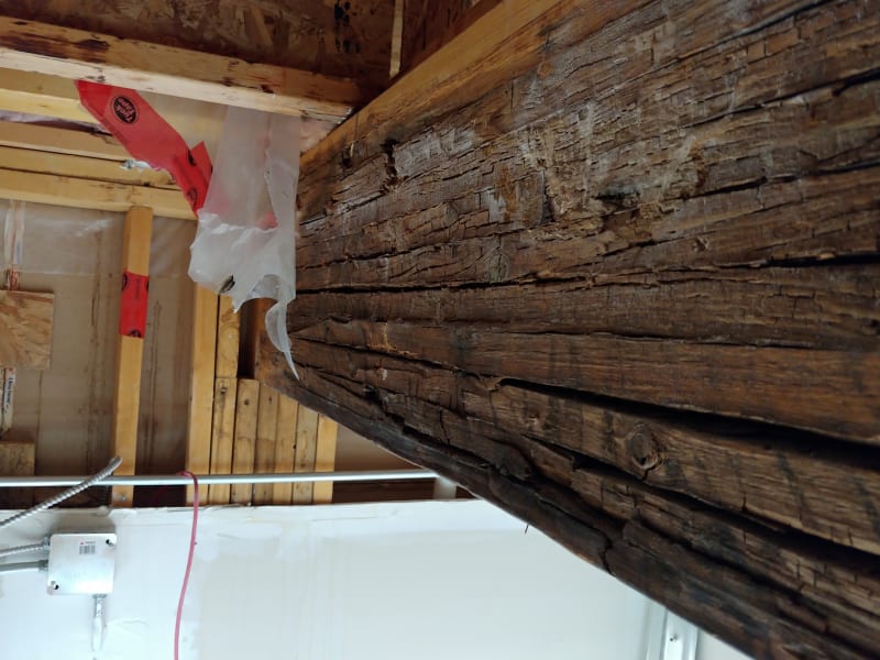

Similar to XR250, but interior. This is in a fire hall, training tower for high angle rescue is above. The training tower had balconies that were poorly detailed and leaked. The original contractor also put the vapour barrier under this beam rather than over it, creating a bathtub in which the water could gather. The result was full delamination, but absolutely no signs of distress above (amazing redundancy of wood framed construction). Was discovered by the maintenance crew who were replacing the lightly stained drywall wrapped around the beam.
Awesome picture. That belongs in one of those AWC webinars in the "glulam gone wrong" slide.

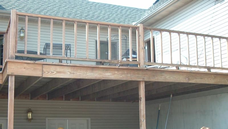

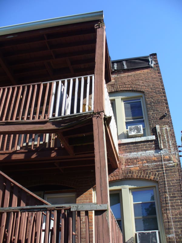

I was once invited to a pool party and saw this deck. Note the spliced band board to the left.
Here's a view from under the deck. The joists spanned from the house roughly 14' out to the single ply band board.
I pointed it out to the homeowner. He had no clue there was a problem. I suggested that he keep everyone off the deck until it was fixed. He didn't seem concerned.
I never heard of the deck failing, but never went back to that house either.
Not to mention that stellar band to post attachment.

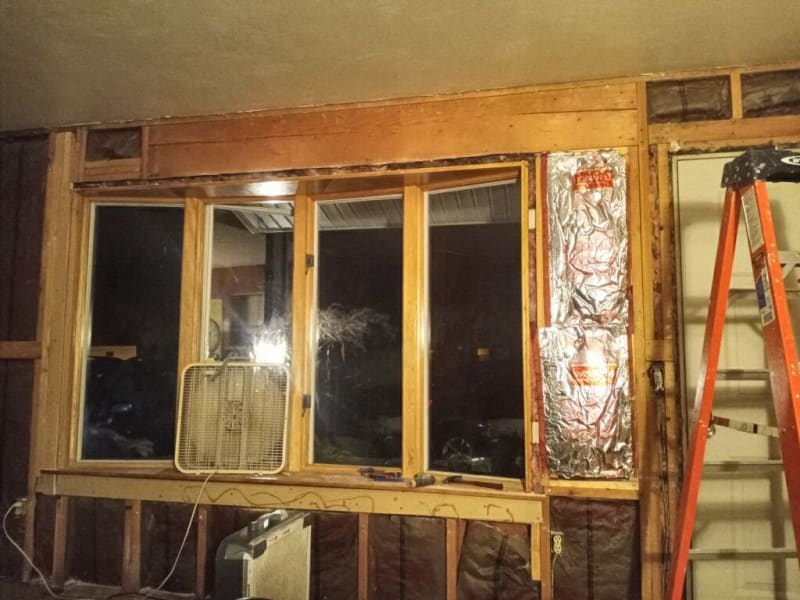

Not a failure, but this was discovered by a new homeowner who knew the previous owners and claimed it had been this way for 30+ years! Located in way upstate NY, just a few miles from Canada. Even with all that snow for all those years, apparently it got the job done.
Wood framing is much more resilient than we can prove on paper but I don't mess around when it comes to decks. That one makes me uneasy just looking at it in a picture.

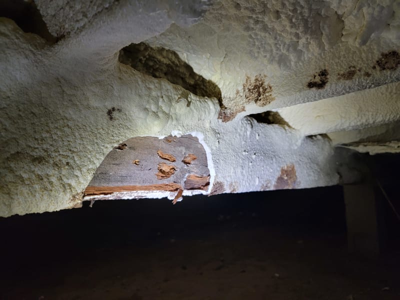

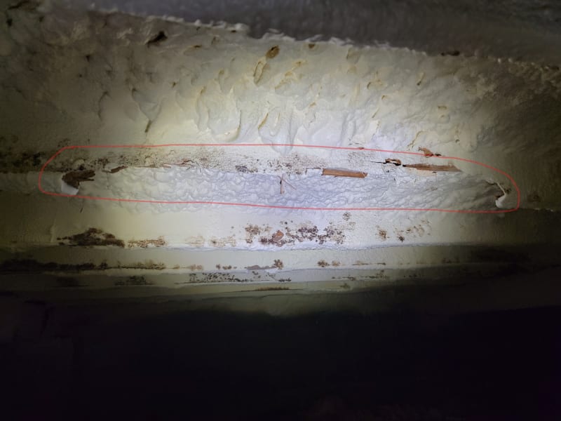

Just before Xmas I went to a house where a lady had gotten her crawlspace spray-foamed 15 years ago. The problem, they used closed-cell foam.
It's hard to describe how rotten the wood was. You can see in the first photo a giant chunk of the bottom of a joist missing. The contractor just pulled it off by hand. It just fell apart. The wood basically disintegrated in your hand. I told him when we were down there, don't touch anything else, this is structural foam now. When they did the repair work the GC said water was pouring out as they chipped off the foam. Never seen anything like it.
