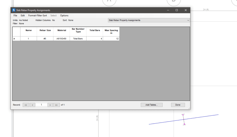

Has anyone had luck with exporting slab rebar objects from safe as a database file, a table, or even a dxf as a last resort? I've been battling it for quite a while and it seems extremely buggy to say the least. It often only recognizes the most recent rebar objects that you've created and ignores the balance. So if you create 100 instances of slab rebar, close the program, reopen and create 5 more and then export as a database file you only see the new 5 objects. I've tried every option and workaround I can think of. It's hard to believe that exporting rebar from a slab design program could be this buggy so I'm hoping someone can point out a fix or what I'm doing wrong.

I played with this a bit and see some of the issues with getting slab rebar out of SAFE.

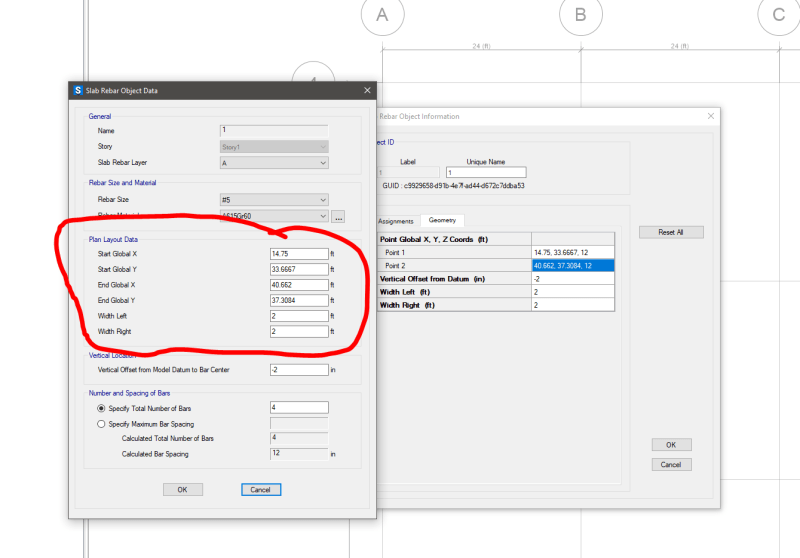

The database tables lack the geometry parameters to accurately define where rebar elements exist.
Seems like CSI should expand "slab rebar property assignments" tables to include all pertinent parameters for easier access and data manipulation.

Using this test model or your own check this out:
- If you manually draw rebar you are able to see the info via display > tables and also edit > interactive database editing (and of course graphically). Now save the model, close it and open a different model and then close that, re-open the test model. Now draw another piece of rebar and do display> tables or interactive database. You will see that only the new rebar shows up. Graphically all of the specified rebar is there, but you can't get to the data - which means that you can't post process and/or manipulate it.
