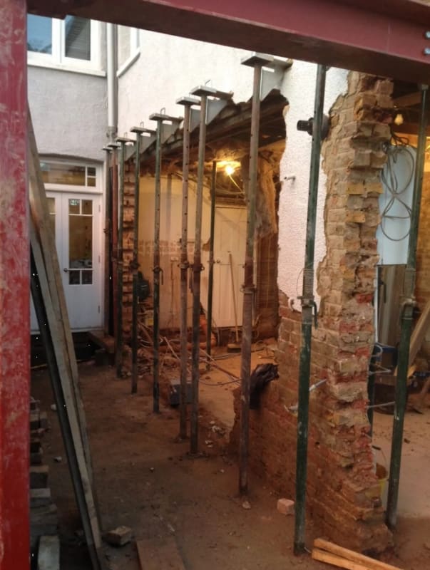

I guess another question is not really my problem (its the contractor's), but I have always wondered how they do this in the field and safely temporarily support the wall left above the opening.

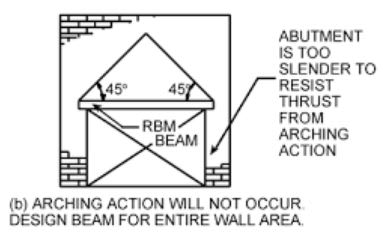

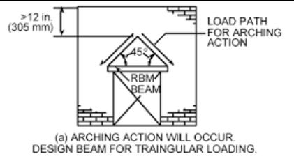

Well masonry walls do arch over and around openings. But only if there is adequate wall length on each side of the opening to resist the arching lateral thrust each way.
So if there's adequate lateral resistance from wall lengths on each side, you can assume that the upper floors dead and live loads get transferred to the adjacent walls and footings.
You'd have to check that these adjacent walls and footings can carry the load without overstress.
Note that the transference of load can induce new settlements in the footings now taking additional force so that could create differential movements that induce cracking in your wall. Not necessarily a structural capacity issue but mostly an aesthetic issue.

As far as means and methods, this depends on the actual project conditions and geometry. Many times, if the opening width is small enough, the opening can be made without temporary shoring as the wall naturally arches - you may lose some blocks "under" the natural arch but these can be replaced by a mason once the new lintel is placed.
Otherwise we've used needle beams located just above the opening to shore up the wall above - again possibly losing some blocks below the needle beams.

I guess I have used the triangle method before. It’s a very tall wall, but no windows or openings directly above it so I guess I just have masonry dead weight and I do not consider floor loads from above (considering they are further away vertically than half my lintel span)
JAE was using 'arch' as a verb. Take a look at the section called 'arching action' in the document linked.
How much of the existing wall to consider as part of your beam? I'd say zero, but the specific reinforcing and opening width in your case might suggest otherwise.
Yes, there's always some arching action in masonry and your description certainly suggests that A) there plenty of masonry above the new opening and B) there some degree of wall on either side of the opening.
The main problem is usually some minor amounts of wall on either side not adequate to complete the equalization of forces (lateral) of the arching behavior.
But to answer your question - yes you can conservatively take ALL the masonry above the opening as the load, but this is very conservative for the lintel design.

For the lintel? Bond beam, precast concrete beam, steel beam/ angles, they all work. Depends on situation. I use a lot of double channels sandwiching the masonry to create new lintels. Saves on having to worry about the shoring/ needle beams aspect because they install the steel first then knock out the block/ brick below.

I have done the double channel. What I do is put what I call 'needle plates' below the channels through a bed joint. They can be installed in a few foot sections at a time. Same thing at the ends to get bearing. I through bolt to wall to tie it all together. It has worked well for me on some fairly large openings.
