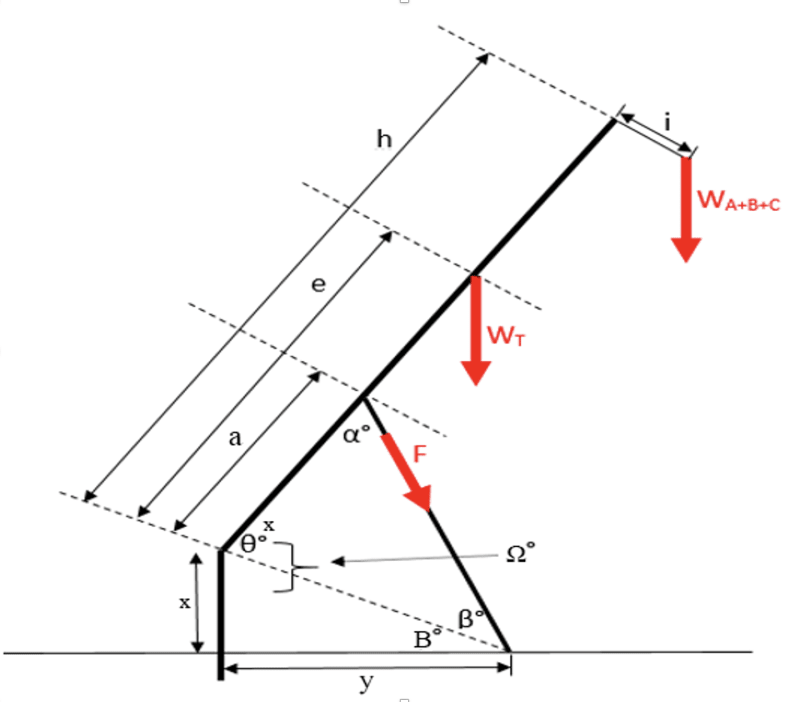

I am currently trying to optimize the location of a hydraulic cylinder on a wind tower which is being erected using that cylinder. Just wanted to know how high can the hydraulic cylinder(2) be connected so that the wind effect is ignored or if there is some guidelines which I should follow.

What’s i and I assume F is the cylinder force ?. Why is W a+b+c acting vertically?
Please put some labels on the diagram so people can understand your problem better.

Wabc is the weight of the turbine
Wt is the weight of the tower
i is the centroid for the turbine weight
e is the centroid for tower weight
h is the height of the tower
a is what I want to find, but right now I just need a constraint as to how high i can go without any significant impact from wind
y is the distance of connection
apologies, but your sketch is awful, close to meaningless.
you're trying to erect the tower on a hill (slope B) ?
position of the lift would be limited by the bending moments in the tower.
lift on a windless day if you're that concerned about wind.
add a wind load (a distributed load ?) to the tower.
Weight acts down, but the hydraulic actuator would act up ...

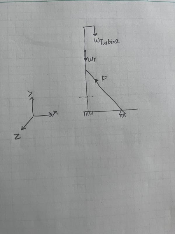

Apologies for the sketch, Perhaps this picture would be of help.
Im trying to optimize the position of the hydraulic cylinder on the tower. with adding the hydraulic cylinder the area for wind will increase ( I believe, Im not sure) so im trying to attach the cylinder as low as possible but I want to know how high it could be attached.

Hi guys sorry English is not my first language so im not sure ill be able to explain this properly but please refer to this figure may be this can help.
This is the tower in upright position, I know that the lower i go the size of the cylinder will be larger but the area created on Z direction to be influenced by wind will be less and conversely i can connect it higher and the cylinder size decreases but the area on Z direction increases. i want to know up to what height can I ignore the wind effects on the area. Once again the wind is coming from Z direction. Im sorry if my question is not clear

you could add wind in the X-Z plane ... a distributed load along the tower
but what about the cylinder, there would be suction and all sorts of things I assume, so I just want it to be below the height where I can ignore all the wind forces (If that is a thing)

So you are talking about the wind blowing in the Z-direction which is perpendicular to the plane of the cylinder and structure. I don't see what issue wind in this direction would have on the placement of the cylinder. Even a 100 MPH wind would only give a maximum pressure of 25 PSF which will be a negligible load on the cylinder itself due to the small projected area of the cylinder. There will no difference in the wind load on the structure no matter where you connect the cylinder. In any case the load on the structure in the off plane direction would need to be taken by the bottom connection pins. Also note that you are not going to be lifting the structure in 100 MPH winds or even 50 MPH wind. Are you?

ASCE 7 covers wind loads on structures.
Basically the wind load is based on the velocity head pressure = V2/2g. So if you have a 100 mile per hour wind which is 146.7 feet per second the theoretical wind load on the projected area of any object when the wind acts on the object at a right angle is:
Velocity Head = (146.7)2/2(32.2) = 334 Feet of head
Converted to pressure when velocity come to complete stop on the object in accordance with the Benouli Equation:
Pressure(PSF) = (Density of Fluid #/ft3) x (Head - FT) = .076 x 334 = 25.4 PSF assuming air density at standard conditions.
So this is the maximum pressure on the projected surface. Now for a cylindrical shape the shape factor for wind loading is 0.6 meaning that the real effective load on a cyliner is 0.6 x 25.4 = 15.2 PSF.
However different codes such as ASCE 7 apply more safety and other factors etc. So if you are designing to Code you must follow ASCE but the real loads are indicated above.
So the wind loading on the cylinder itself would not be that great I dont think and it would basically cause out of plane bending of the cylinder. However if you are designing for a significant wind load during lifting then the wind load on the structure will cause a deflection of the structure which is greater as the height above the base increases. So if you connect the cylinder to a point that is high and has a lot of defection the cylinder is going to deflect with it assuming the cylinder is not strong or rigid when bending sideway. This could damage the cylinder. The base of the structure pinned connection point will need to be designed for the full design wind load.
