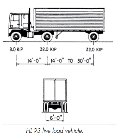

Slab is drive way for truck traffic.
What loading assumption is being used for design?
Perhaps AASHTO HL-93 Live Load?
