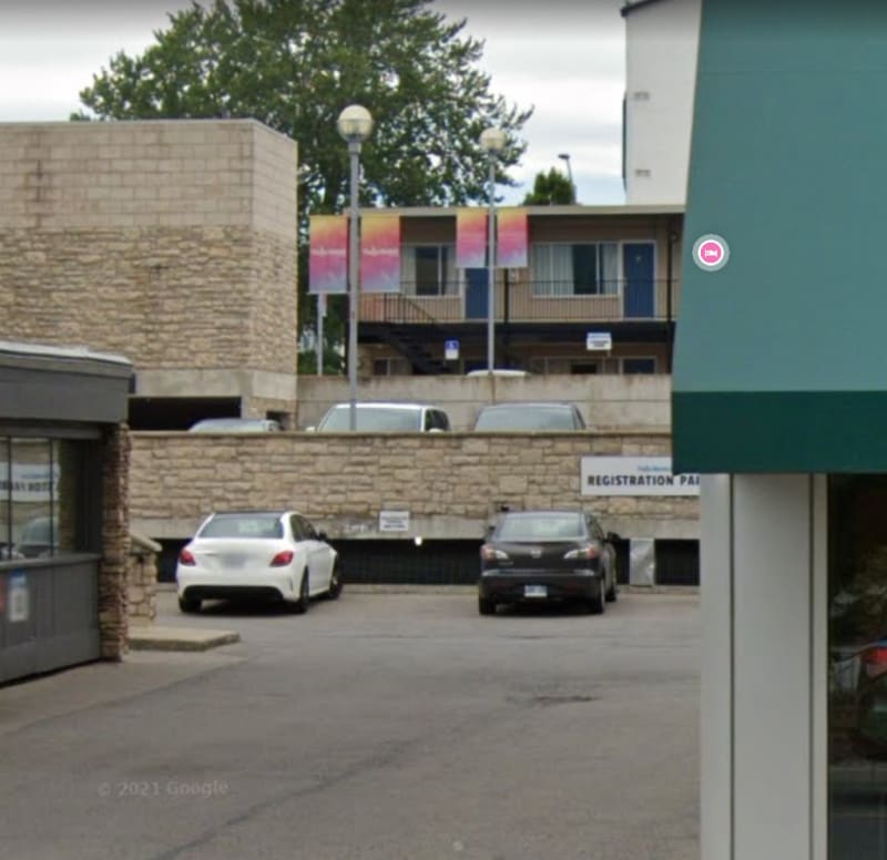

According to the reddit OP this was photographed in the parking deck below a 6-story building hotel. But some google mapping it appears that this is not under the building but in the parking deck adjacent to the building. So, the the damaged portion of this column appears to be supporting only one level at the top level of the garage. Photo 'evidence' at the bottom of this post.
The OP has reported this to the building department and they are aware of the "issue".

My guess would be some sort of thermal expansion of the decks that would be opposing each other? Doesn't look great, but better than being a main building column. Discuss!

Looks like a progressive collapse that has already started, but the progression is slow. The Reddit poster says that the parking extends under the small tower. Champlain Towers South, by one of the popular interpretations of the collapse sequence, came down from something not that different.
