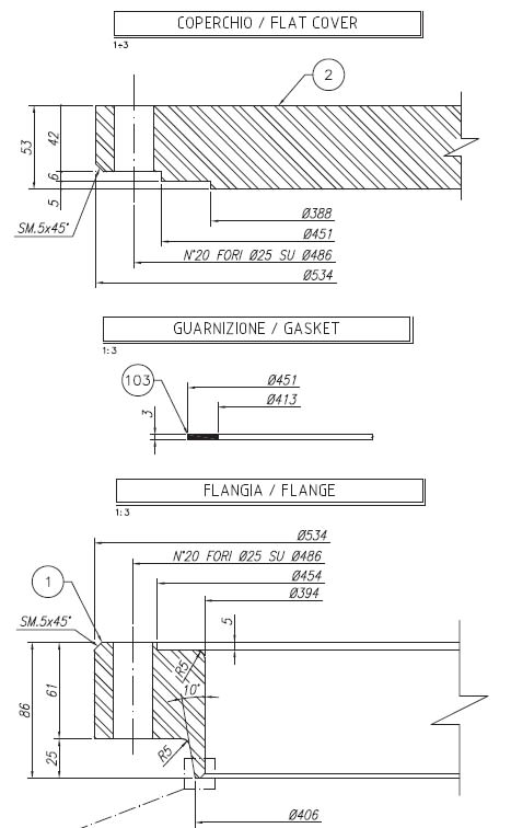

What is the ideal configuration for flange surface finish and type of gasket for hydrogen service at 80°C?
We have initially designed the flanged joint with a PTFE Virgin gasket on a 125÷250 microinch surface and we have noted leakage.
Is it possible that this configuration is not the ideal one for hydrogen service?
Thanks in advance

Entirely. Have you considered consulting with Flexitallic or Garlock or somebody?

Virgin PTFE will creep a lot, you need a filled grade.
Talk to your gasket supplier.
H2 isn't hard to work with (not compared to O2 or He).
TGS4, the code of construction is EN13445, design pressure 35 bar, the geometry obtained is the following:
SnTMan, both Flexitallic and other suppliers have recommended this type of gasket to us. A fundamental requirement, since ultrapure water is also contained in the vessel, is that the gasket cannot contaminate the fluid in any way.
EdStainless, filled like spiral wound or corrugated?
Could be a Spiral Wound gasket filled in PTFE a possible solution?

No, PTFE with glass or carbon fiber mixed into it.

EdStainless, so do you mean a flat sheet of PTFE mixed with glass or carbon fiber?

Note that hydrogen and hydrogen-enriched service is a common situation in petroleum and gas processing industries. As per my experience with hydrogen service common choice is spiral wound ASME B16.20 with 304SS windings and flexible graphite filler. Modified 304SS inner metal ring in case of high pressure service.
NASA is a good practice but the question is - does a widely spread&accepted practice require a rocket science?
As per my experience PTFE is the worst choice available because of this material has no memory. PTFE gaskets shall be avoided where it is possible.
I would use a spiral-wound gasket (300SS windings, Flexible Graphite filler) with inner ring but without outer ring for these male/female flange faces (e.g. Flexitallic RIR). 125-250 micro-inch flange surface finish is fine for these.

Krausen, do you think that the graphite filler could be acceptable for service with ultrapure water?
