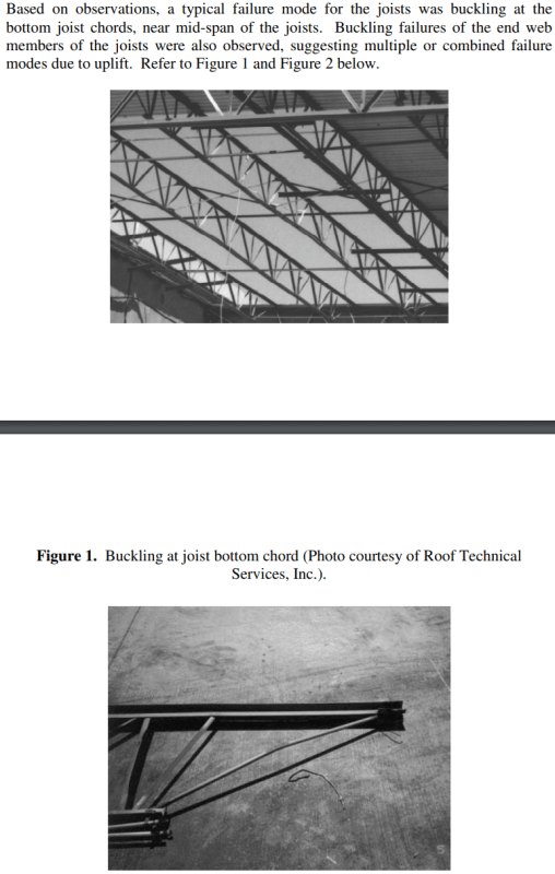

There is a building where I grew up that has the first 3 or 4 bar joists near the exterior wall with buckled bottom chords. I'll try to see if I can find the photos. My first thought was that something hit them, but they are high up in a gym and lifts are rarely used (maybe just to change light bulbs) and it would seem a little difficult to smash into multiple joists like that. It's the only time I've ever seen anything like that in a bar joist framed building and my best guess for why they are distressed is some sort of wind uplift issue since it's right near an edge.

You can find quite a few joist failure on older building. Sometimes it can be misleading because the joists will remain in place and the metal deck is missing. My understanding is the joist buckles, loses stiffness, then the deck has to span twice the length so the connections fail like a zipper. Bye bye to the deck but the joist can remain.
Joist failure
The photos are better in this one. Joist Failure
Yes, this one article I found myself as well, right after I posted here.

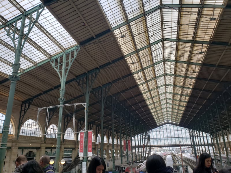

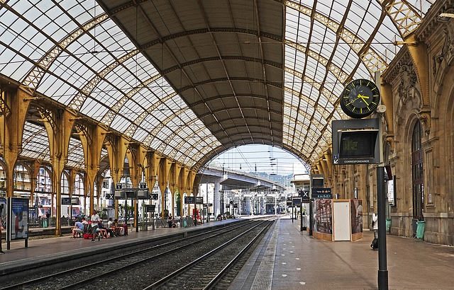

I don't know how much this will add to the discussion but I noticed a lot of what I assume are Victorian era structures in Paris have trusses that just have cables for the bottom chords so zero ability to resist compression. I'm thinking that if your main roof structure is heavy enough, you can ignore uplift compression forces on the bottom chord.
SandwichEngine - I think the key to your pictures is that they can't resist compression even if they wanted to and, therefore, cannot buckle. That load path simply doesn't exist. Where it does exist and it is stiffer than the top chord acting as a beam on its own, the buckling concern is going to be valid.
Rods buckle just fine. They’re just as stiff in compression, but they buckle before any significant proportion of the compressive stiffness is mobilised.
The second photo isn't a truss. It is an compression arch with ties to resolve the outward forces from gravity. Being curved negative with loads would be entirely different.
The first photo isn't clear entirely what is happening. If the diagonals are tensile members then the members you are referring to are for upwards forces! But these could just be ties to stop outward forces too. But I can't tell from the limited information.
It’s a similar scenario to trusses though. Transient compressive loads in unrestrained bottom part.
We’re dealing with one of these tied arches at present. 100+ years old. The rods are a pair of angles. The ties don’t work in theory against the uplift. It’s a tricky one. Do do the arches lift a bit, and then flop back down again, like those trusses in the photos above? Does it actually fail?
What the buffer between the bottom chord buckling and the structure actually failing?
