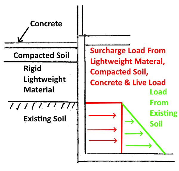

DoubleStud - Excavate to the elevation of the garage floor and use lightweight material from that elevation.
If this is not done, the weight of the lightweight material + compacted soil on top of lightweight material + concrete slab + live load on the concrete slab become a surcharge load applied to existing soil outside the garage (see my sketch). This could significantly increase the load currently being applied to the wall by existing soil:
