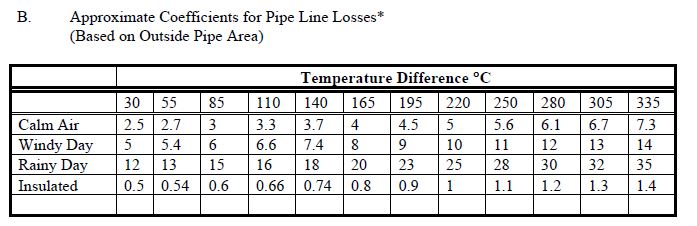

Hi, I've been offline all week. I'll share a quick calc from a previous company's design manual.
[Δ]T = 176 - 21 = 155o C = 279o F
U = 0.78 Btu/hr/oF/ft2
A = [π]DoL = 3.14 x 7/12 ft x 85 ft = 156 ft2
Q = UA[Δ]T = 0.78 x 156 x 279
Q = 34,000 Btu/hr
Wcondensate = Q/[λ] = 34,000/(1203 - 287) = 37 lb/hr

Hi Latexman,
The table you shared is very helpful. Would it be possible to email me this cut sheet with the relevant pages of the manual.
In you calculations you took Do= 7" , it is actually a 3" pipe. The OD is 3.5 inches.
Ao = PI()*(3.5/12)*85 = 77.92 ft2
With this I get Q = 0.78*77.92*279 = 16956.95 Btu/hr
Please let me know how you got the heat of vaporization value of 1203-287 = 916 Btu/lb

Hi Pavan,
I sent the e-mail with attachment. Did you get it?
Yes, I realize it says "(Based on Outside Pipe Area)". You may be right, but on insulated lines I've always used the bigger more conservative number, the outside diameter of the insulated pipe. And, yes, I did it fast and sloppily, 3" NPS + 2" insulation + 2" insulation = 7". I left that company in 2001, so I can't ask the guy that wrote that section for advice. Sorry.
On heat of vaporization + superheat I used your "1202.748 Btu/lb" of the superheated steam and subtracted the enthalpy of the sat'd liquid at 70.3 psig, 286.55 Btu/lb, from Crane TP410. I didn't know what reference you were using, but . . . that's what I did.
