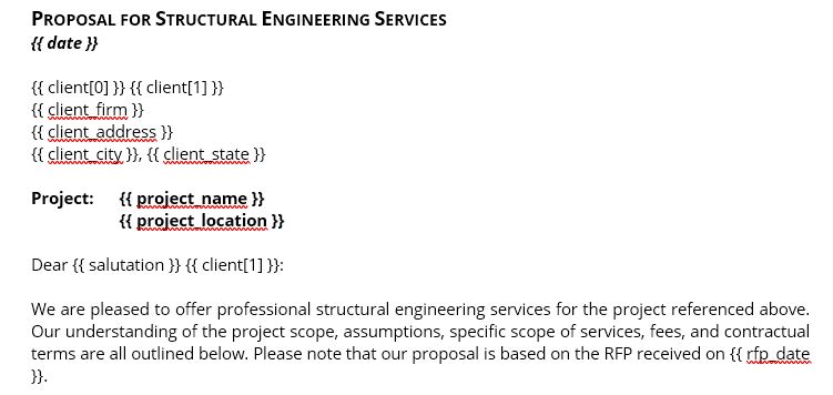

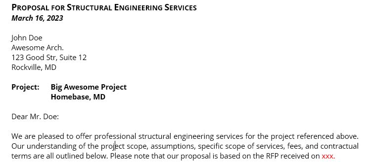

Since you've looked into python a little bit take a look at these two modules I've used them successfully for proposal templating and have been exploring use with Structural Notes.
Methods for manipulating Docx Files:Python DocX
Module to implement Jinja2 Templating within Docx:Docxtpl
Something I've been looking at as a means to possibly format notes to various sheet sizes in multiple columns using Jinja2 for elements that would need to be edited on a per project basis: Link
Example:

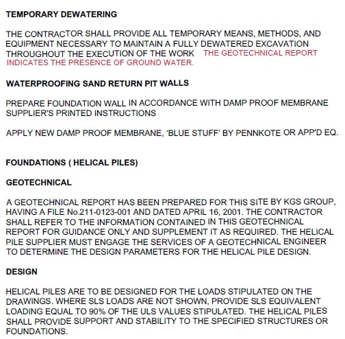

From one of my latest projects... The 'red' has to be added. I insert the modified project notes using mtext into cad dwg and then bold the headings. I also insert drawing blocks to show section marks, grade, etc. images.

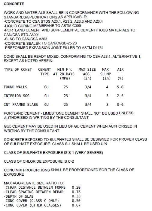

I use monospaced font for tables... 'Deja Vu Sans Mono' is close to 'Arial' and you end up with...

I use all caps because the other drawing notes for sections and details are generally upper case... just old school... I should have added that with the large number of drawing notes, I use 5/64 font size... may be tricky with lower case.
Other critics are of the opinion that all caps letters in text are often "too tightly packed against each other".[35 said:
I have no difficulty reading the notes I have pasted above, and my eyesight is slowly getting worse... specially when a ANSI D sheet is printed at 11x17.
Dik, yes you probably use all caps because the other engineering companies use all caps. Obviously I'm not criticising you personally since it is every engineering company. It's just odd that the only reason I find that engineering companies still use all caps is that it's tradition. Even after scientific studies show all caps is harder to read by the general population and all other industries have changed to lower case. I think you'll find if you test changing to lower case then after only two or three jobs you will prefer it. As for the font size, when using lower case I can actually increase the font size by 1.41 times and it fits in the same page area as all caps (as long as you are not using mono spacing).
Increasing the font by 1.4 would mean the number of drawing note pages would increase from 4 to 7, or 3 to 6, or whatever... seems a little much. All my details which I often reuse would have to change, too... thousands of them. I think I'll stick with upper case.
