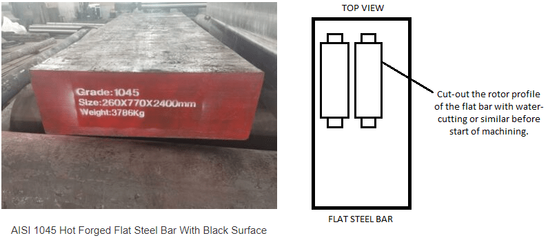

Preferably the best solution for us would be if the rotor could be machined out of a round or flat bar, but then I understand that this is not a proper forging and you run into this kind of problem in the material structure:
Micro structure of a bar
Micro structure of a machined bar
Micro structure of proper forging
Is this understanding correct? Meaning that we can't machine our rotor out of a solid hot-rolled or cold drawn bar? Even if the bar was properly forged I understand that we can't create the rotor out of the bar to benefit from the proper forging process? If this is correct, then I guess that the proper rotor raw forging must look very must similar to the final shape of the rotor? For example the final dimensions +3 mm or whatever tolerance that is needed to machine the rotor clean? Is it even possible to forge such a screw rotor?
Or what is the meaning of "AISI 1045 forged" in this context, what would satisfy the standard as well as the demanding customers of such compressor?
